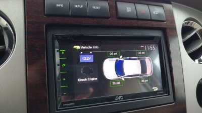

Here is a picture of my Kenwood vehicle info screen in my 2007 Expedition EL Limited. When a tire is low the green boarder around the rectangle turns red. The dash indicator for low tire pressure also comes on.
In the Kenwood manual it shows actual tire pressure readings inside the green rectangle.
Hope this is clearer.
My question- Is there a way to get the kenwood to display the actual pressure reading?
It gets info and displays actual readings for voltage, engine temp, rpm,oil pressure, and lots of other parameters.
As info, the Kenwood is connected to the expedition OBD
I felt that if it gets actual readings for all these parameters then air pressure should be available.

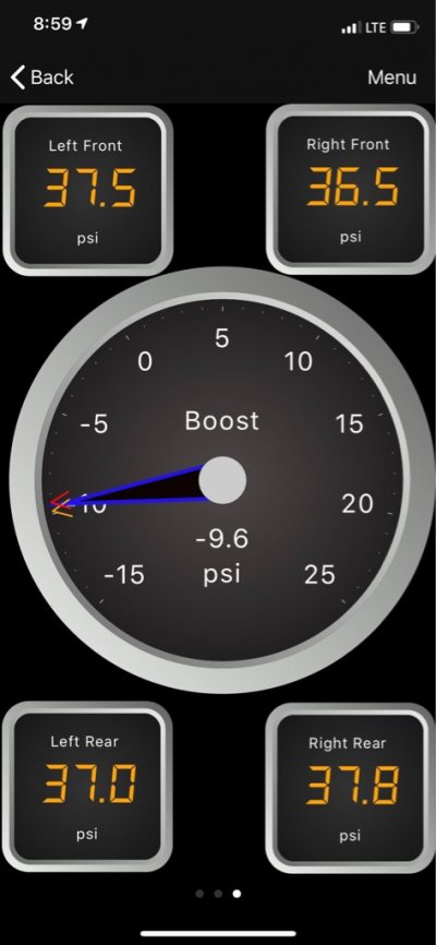

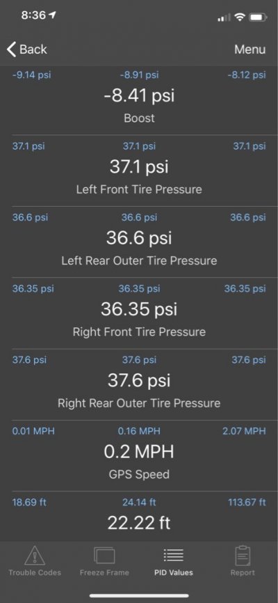

When using the same PIDs on the Expy that I used on my Edge for testing it did not work.
The PIDs were slightly different for the Expy.
The things you mentioned are standard OBDII PIDs. The Tire Pressure ones are extended/enhanced. That could be the difference.

Did you see my images above, clearly not just a good/bad signal?
Now there is the possibility(Small) that the earlier 3 Gens might have different sensors. But as was mentioned before that would make less sense. It makes more sense that the sensor just sends pressure and the BCM makes the decision. That allows different set points. A sensor that sends good/bad would have to have the set point hard coded and make a logic decision.
