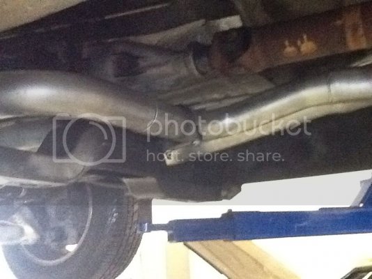

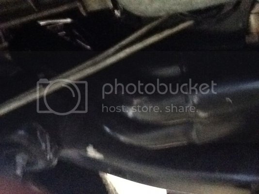

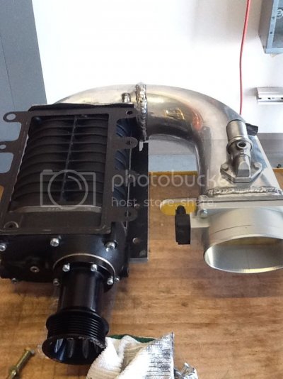

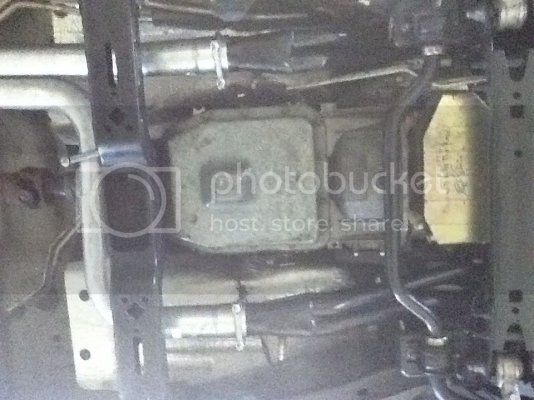

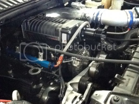

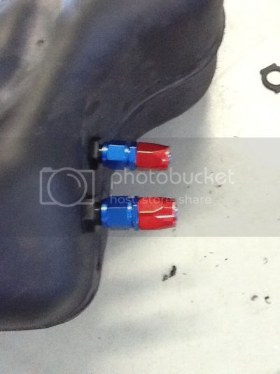

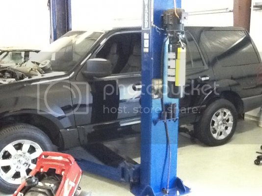

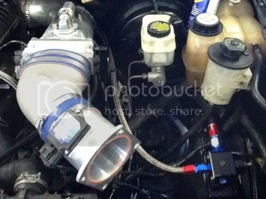

So i wasnt making enough power hehehe So i ripped my tank down tapped and threded the tank for 10 -aN supply and 8 -aN return lines and new 11/16's Fuel rails with Deka 90lbs Injectors with boost proportionate fuel pressure regulator and alcohol injection system, I should make over 750 to the tire now im alittle excited, still searching for all my original build pics
