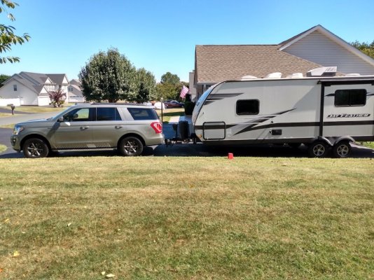

What are you guys having problems with when backing ???? I have a 2019 with tow package, standard mirrors (no extensions or clip ons) and tow a 28 foot Jayco with standard 8 foot width. Never have a problem towing or backing into spaces.
Just takes plenty of practice.....taking the rig out once or twice a year won't hack it. You need to practice enough that it just becomes second nature.
