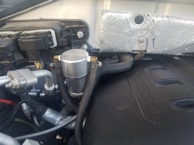

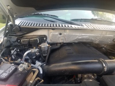

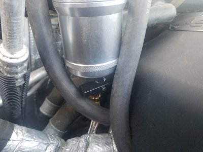

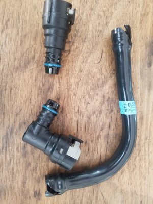

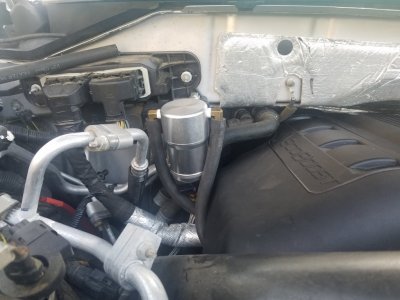

I never posted pictures of my catch can set up. If you are careful, you can slice the plastic tube off your factory connectors and easily attach a 1/2" rubber tube. I changed out the 90 degree fittings that came with the can for ones that are 1/4"x20 npt to 1/2" barb.
I also added a different drain. It was one for a compressor that moves the drain point so I can put a can under it easier.

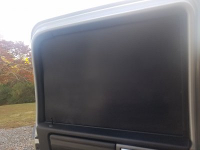

As far as my Expy "camping" thread goes, I created some black outs for privacy. I initially tried fabric, but you end up loosing all the shelf space and it just didn't work well. These pop in and pop out nicely. With these and a "twin" fold up bed with the legs modified for height, it's pretty comfortable. Nobody has a clue you're in there either which is nice.

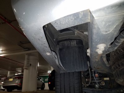

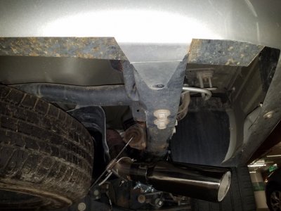

Exhaust Mod: Switched to side exit exhaust

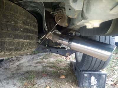

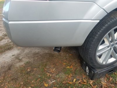

Here are a few pics of my exhaust mod. Removed the 15-17 resonator can and moved the rear exit to a side exit. Easy job and well worth it. No more exhaust in the face when you're loading the cargo area or attaching the trailer.
