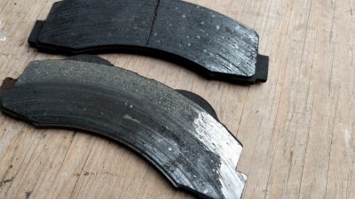

Changed out pads and rotors last week. Was surprised to find one pad (outside only) worn down to nothing. I had just put these cheap pads on 6 months ago in Canada while on a trip. (After replacing struts and stuff before the trip, I looked through the caliper and figured I'd make it. 800 miles later at our destination, and I was hearing grinding...).

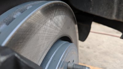

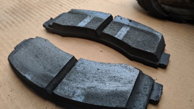

The edge of the 'painted' rotor looks like the heat has flaked the paint off. The inside of edge looks normal. The wear on the new pads AND rotor is not completely across the surface. Only half the pad is doing anything. I even think the pad has a crack in the surface.

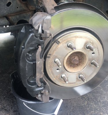

I'm guessing I need a new caliper.
Can I buy Wearever for $75 or do I need the Motorcraft for $150, if this is my problem?

I will add that the one pad (I think outside pad, same one that was worn down last time) had a lot of brake dust already in the little 'v' between the two section of padded material on the pad.

Get a caliper at O'Reilly or Advance and use some sandpaper to scuff up the rotor a bit. I use 90-100 or a little round buffer pad on air tool.
Did you check the calipers and pins when you did the pads to make sure all was free and greased well?
I can tell by the way a piston pushed in with c-clamp if it is sticking.
I actually lift the dust seal up around the piston and spray wd-40 and usually lucas chain lube all around the piston before I press it in. Helps free up stuff and prevent later sticking and corrosion.

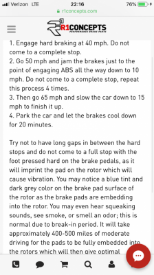

Did you follow the proper break in procedures for the pads and rotors? There is normally a 5-7 minute procedure required to seat the pads on the rotors for them to imprint correctly...

Like Toby says, check your caliper pins. Make sure they slide. Clean and grease them. If the caliper is bad you'll know it when you press in the pistons.

I admit, I don't know about the break-in procedure. I've done a "good number" of pads over the years (my own vehicles) but will be glad to know more.
I did not check the pins and will do so today.
