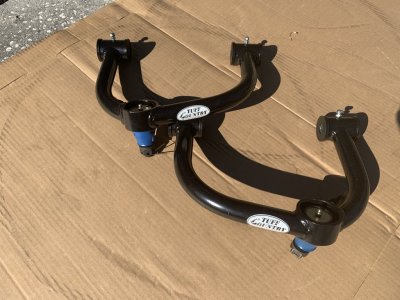

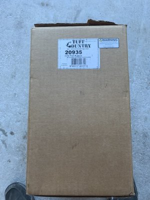

Anyone running the Readylift 3/2 lift have issues with their control arms? These TUFF COUNTRY 20935 are made for 1-3" of lift and should reposition the ball joint. Think it would help or is needed? If im going to take it apart to install the lift I might as well do these at the same time if they are needed.

They aren’t “needed” but a good idea.
You/we will put more wear on the factory ball joints. Not a severe detriment but they’ll certainly need replacing quicker than if not lifted.
Tuff Country appears so be one of those entry level companies.
Certainly better than OEM for the price. Interested in who’s ball joints they use.
I am planning on BDS Control Arms but they are twice the price. Had not seen the Tuff Country before may look around the F150 forums for reviews.

Been reading and reviews appear to be good and they are made in the USA.
Their website says that they will not work with factory wheels. Also states it uses a standard ball joint. So two big negatives.
@Black good catch on the factory wheels. I didnt notice that. I did see the standard ball joint, I was ok with going with that over the uniball mainly due to cost and how limited I will probably be doing off roading.
If it is an upgraded/beefed up ball joint that is a standard style that is fine. Likely more desirable since you are in Michigan I am guessing you get lots of road salt like we do here (probably more). Uniballs and road salt do not play nicely.
BDS uses an upgraded Moog standard style ball joint.
So the question is what specific ball joint do they use. Also are replacement joints easy to find.
Icon also has their delta joint.
http://www.iconvehicledynamics.com/deltajoint/
