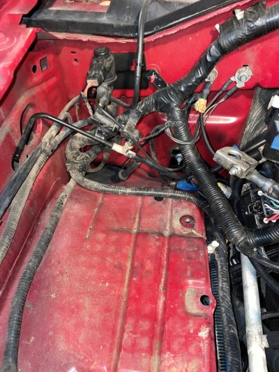

I have that same problem with the lines that come out from behind battery and connect to that solenoid and then connect where? I've been looking for a diagram for vacuum and AC lines so I can replace and get everything back working right. 03 5.4L 4x4 EB .

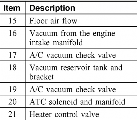

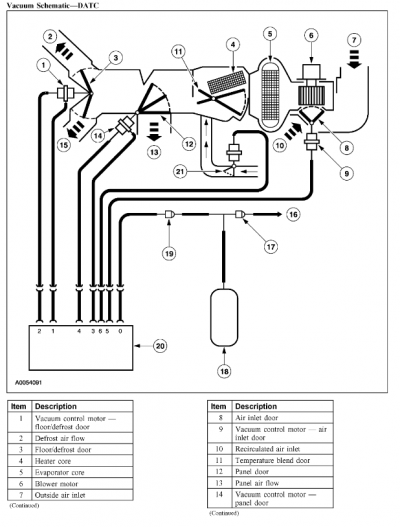

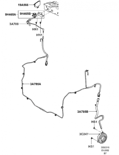

Thanks so much whtbronco. Are those numbers the part numbers on the vacuum diagram? 1st page?

Those are the base numbers, which is a portion of the part number. That 1st diagram is also only for the front 4wd hubs. In that diagram the vacuum harness that often fails due to age is Ford P/N 4L3Z-3A788A-AA, the base number is 3A788.

Ok. Thanks whtbronco. When I get the chance I'll take pics of the area and get back with you. Someone sabotaged my vehicle, and haven't been able to find any diagrams, pics or anything to know what's missing/cut to fix. Don't have washer fluid at wipers and 4x4 lights in dash will come on briefly on occasion.

I went back looked at your pic and diagram. That's exactly where mine is cut and missing that check valve and what it connects to. Thank you thank you thank you whtbronco. You're a lifesaver!!
