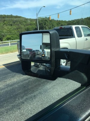

Good to know, hopefully I won't get struck by lightening twice. lol. When I did the first trans service on my Expedition the pan was quite clean, very little clutch material and very little on the magnets.
As a side note, I just can't say enough good things about how well the Expedition tows our boat.. it's made towing long distances much less stressful. Now if only the side mirrors were a little larger.
I hear you about the mirrors. I had a set of Trail Ridge telescoping tow mirrors on my 2008 Expedition, and moved them over to my 2016 Expedition XLT when I bought it a few months ago. They were an exact fit, except the left/right control doesn’t work (probably a wire schematic issue), but all other functions work. I can manually adjust the left/right, small sacrifice for the MUCH better visibility these mirrors give when towing our 30’ travel trailer. Just thought I’d mention it as there are bigger options out there. Photos are below, and show the mirrors in the collapsed mode. They telescope out a few inches for towing.
