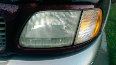

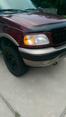

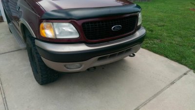

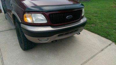

Finished my headlight upgrades this weekend!
New black background Euro style clear headlights and crystal fogs. Much better lighting with MUCH better looks!
New look
Old factory look
Well worth the money so far!!!
SWEET look! i plan on upgrading my head & tail lights. where did you get get the clear fog lights from, & how much did they set you back?
