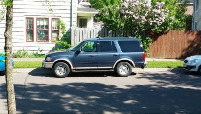

I had the pleasure of spending more money on repairs. Had my 98 in to replace the Actuator for the front axle. PITA to get the old one out!!! Only spent $80, including installation.
