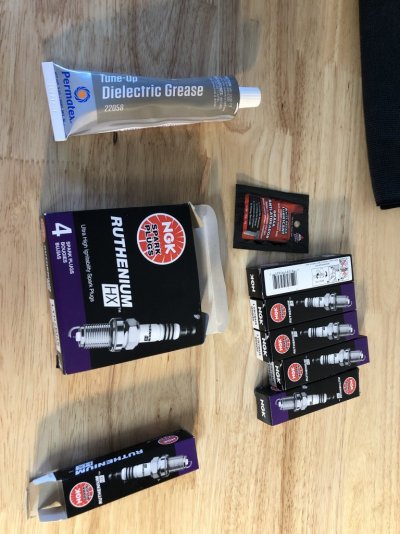

Installed a set of NGK Ruthenium spark plugs gapped at .028. Expy drives like it did after I had it first tuned (big difference). Only 2 of the old plugs were white at the electrodes. OD 47k.

just did mine with the NGK’s @ 53k / did the boots since i was in there already. was occasionally getting occasional slight hesitation under heavy acceleration.... runs like a champ now + gas mileage up immediately. thanks for the tip @LokiWolf !!!!!

Glad to help! Great plugs!

According to the description on the RockAuto site, they come pregapped at .032? If tuned, or regularly running hard, .028 is the better gap. You mention that yet the description says .032?

@LokiWolf Thanks for recommending these plugs in the first place! So, rockauto says gapped at .032 when I measured them they were all at .030 or .029. I gapped them to .028.

If you are having a rough idle, or are tuned, at least pulling your existing and checking gap is a good idea. My thoughts, if I am going to pull them to check, might as well pop a new set in. These WILL be better plugs than the ones that come in from Ford.
