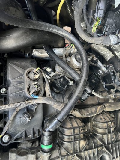

Installed the catch can today. Dropped the second speed clip, never to be retrieved, when I was drilling the second hole a little larger. Drill bit fell down the abyss as well lol.
Luckily, they also supply nyloc nuts, so nbd.
Old (stock) hose came off fine. Did the valve cover end first so I could rotate the intake end to get better access to the tab side.
Tried a few ways of routing the hoses so I could refit the stupid engine cover. They seemed a little long for the application. Hose to valve cover fitting I snaked under a boost pipe. On the intake the elbow has to face toward the rear. I did manage to get the cover back on, but it is being pushed up a bit by the hoses. Thinking this spring I'll remove the cover and trim away on the underside where it's contacting the hoses.

I also had trouble getting the engine cover to fit properly without it pushing down onto the pcv valve fitting/hose. I had to trim that area under the cover. I used a utility knife to carve out the foam. Cover fits perfect now. Thankfully the covers are made of foam and not hard plastic.

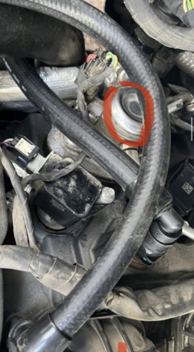

My intake hose is routed the same as yours but I dont have my pcv hose going under the boost pipe and its laying my on top of the thing circled belowWhat is that silver thing anyways?8C9C832C-3B1E-4D88-959A-3D8E97CE0DD9.jpeg

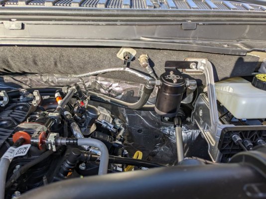

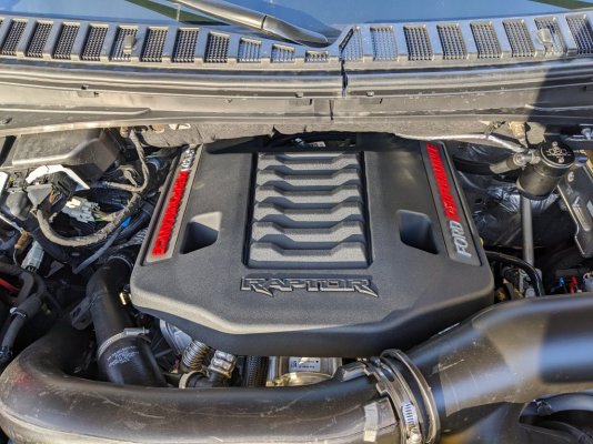

J&L catch can, Raptor engine cover, and Gorilla solid lug nuts today. Added at least 10HP, LOL. And yes, it's filthy. It was nice out today, but not get-the-hose-out nice.

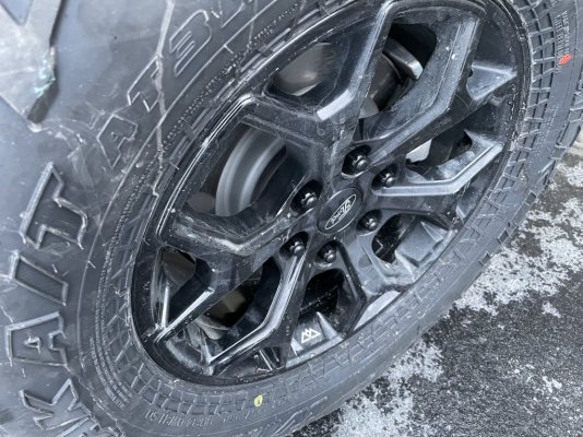

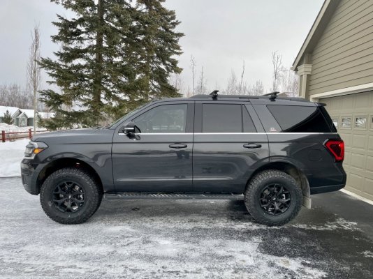

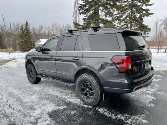

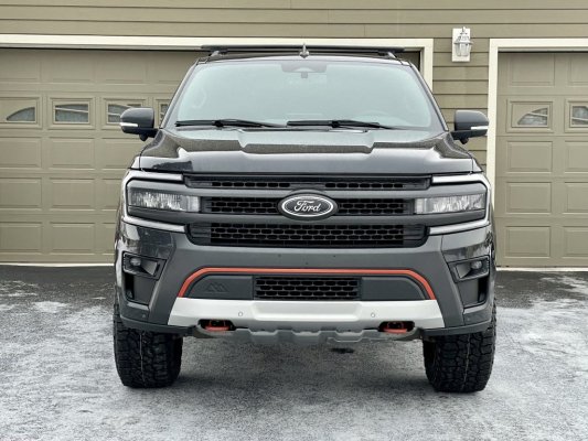

Had a ReadyLift 1.5/2 lift and Falken Wildpeak 295/70R18s installed. Also had them replace the lugs with some black splines.

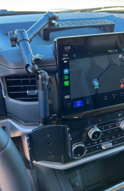

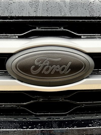

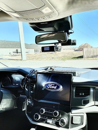

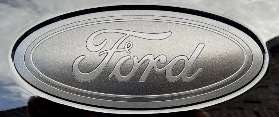

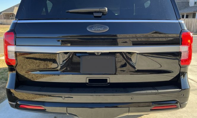

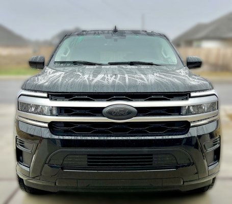

I’ve had my 22 Expedition for about 4 weeks after trading in my 16 Navigator and I’ve managed to get my radar detector and dashcam installed under and around the rear view mirror. Installed a Bulletpoint rail system to mount my phone and future devices. I went this route after tearing the dash apart looking for a way to fabricate a mount to attach somehow, there are no good screws to attach to even though there are so many parts that just clip on. I also removed and painted both the front and rear emblems and debadged all the chrome badges. I was hoping to find the black Limited “E X P E D I T I O N” lettering and from I can tell you can order the panel but I don’t think it comes paint matched, that being said I like the clean look of them removed. I also swapped all the rear incandescent bulbs to LEDs and disabled hyper flashing via FORscan as well as the double honk. Oh and Installed the J&L Oil Separator.

Looks good! Could you post a few more details about your Bulletpoint mount, and how your install went? That‘s one item on my list.

I purchased this one since there isn’t an Expedition specific version. There is a big cavity underneath the center dash, I wish my ‘22 had a removable panel, because it is very difficult to get your hands inside, even with the 12” screen removed. I used the included bolts with hex nuts which is what made the install so difficult. Bulletpoint sells these Well Nuts and I would go that route to avoid having to stick a long box end wrench to stabilize the nuts from underneath the top panel, I might redo it with some I was only able to get three bolts tightened down cause I dropped a nut and didn’t have any spare at the time. Even with only three bolts tighten the rail doesn’t move.

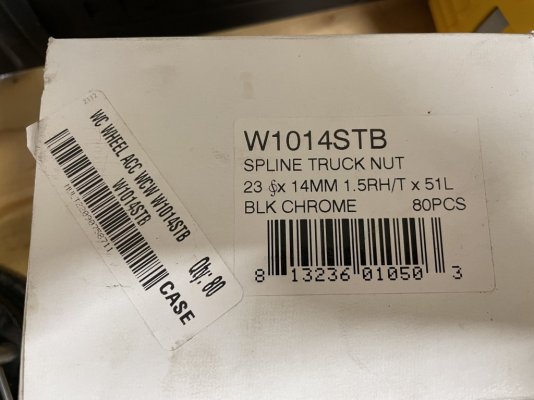

Looks awesome!! Any chance you have a link or part number for the black spline lug nuts? (That’ll have to do for now with the “I just bought a new Timberline” budget realities )

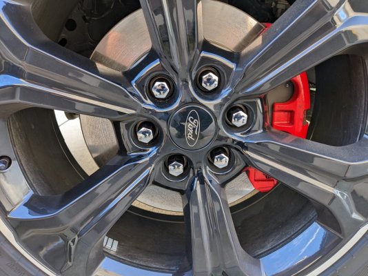

According to the box they gave me containing my factory lug nuts, they are West Coast Wheel #W1014STB lugs. A quick Google returned multiple sites selling them. The product pictures look like what they installed, but you'll want to confirm the size. And, don't forget to purchase a lug nut key if it's not included. (I apologize for the dirty wheel pic, but it's tough staying clean this time of year in Alaska.)
