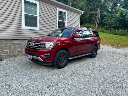

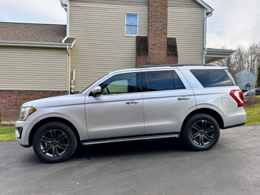

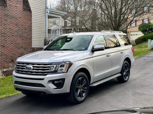

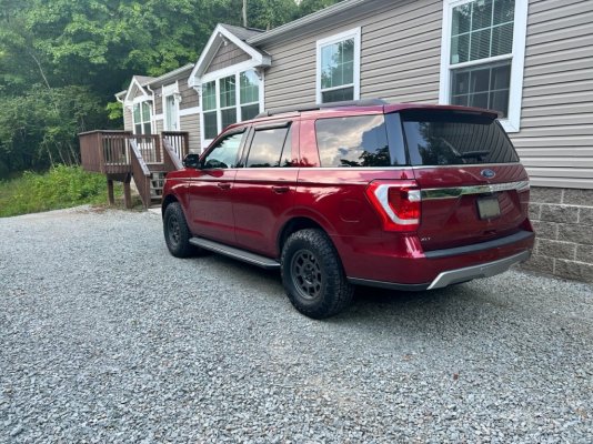

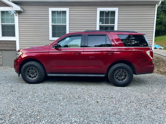

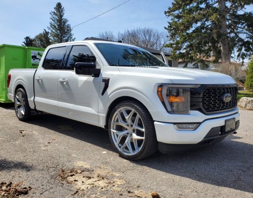

After 30k miles, my BFG KO2's (OEM Raptor take-offs) were nearing the end of their usable life. Not to mention getting noisy. Wanting to switch it up a bit, I went in a different direction looking for more comfort.
I picked up a set of OEM F-150 Sport wheels that were new take-offs for a great price ($1k shipped). I removed the Bilstein 5100's, adjusted them to the lowest setting, and reinstalled. Mounted up the wheels and tires and this is how she sits now.
I'm happy with the switch. The tires are much more comfortable and quiet. Performance is improved having shed 32 lbs per wheel/tire and MPGs are up. While I was a little hesitant to change it up, it turned out better than I expected. And I still have my old LX-450 (Land Cruiser) for trail duty in the warmer months.
Now to switch out the lug nuts for gray/black and black out the chrome trim. :)
Edit to add: I was fully expecting the rear axles to interfere with the wheel center caps, but they cleared just fine. :shrug:

^ Those look great, may have to keep an eye out for some.
Similar to the OE 20s that our Max has, but like the darker shade.

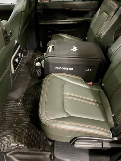

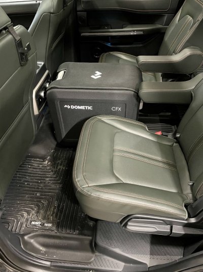

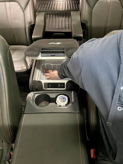

I'm pretty sure the console fridge would fit. We opted for the console safe because we like having a secure place to put my wife's purse, passports, or other vital travel items when on a road trip. We have a Dometic CFX3 25 that we use between the captains chairs in the second row. It offers more flexibility since it's not permanently attached to the vehicle and has more useable space. I don't have it in the vehicle now since it's winter and -10°F. I could throw it in and take a pic if you're interested in seeing what it looks like.

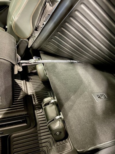

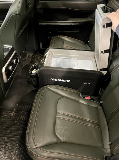

One of the other forum members inquired about the Dometic CFX3 25, so I thought I'd share some picture of how it fits between the seats in the second row.
In the forward position, I can easily reach the bottom of the cooler with my seat slid all the way back (I'm 6'2"). It's a little tippy (forward/backward) in this position due to the floor contour, so you have to shim the front a little.
Our preferred location is towards the back. I can't reach the bottom of the cooler from the driver's seat, but I can easily pull bottles of water out. The armrests have to be up, but it makes a decent armrest replacement for rear passengers especially if you through a blanket or pillow on top to make up for the shorter height. The cooler is much more stable on this section of floor. Having it back further allows for a strap to be ran from the cooler's handle to the child seat anchor on the folded center third row seatback. This stops it from sliding forward during hard braking. We use the other handle to hang a molle dump pouch lined with a doggie bag for trash.

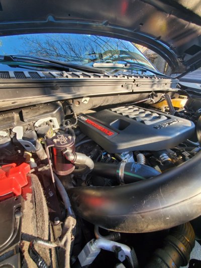

Picked up J&S oil separator for both the SPP and the 5.0. Installing both a breeze; brackets not 100% lined up but a drill made quick work of it.
Cleaned them both up while I was at it.

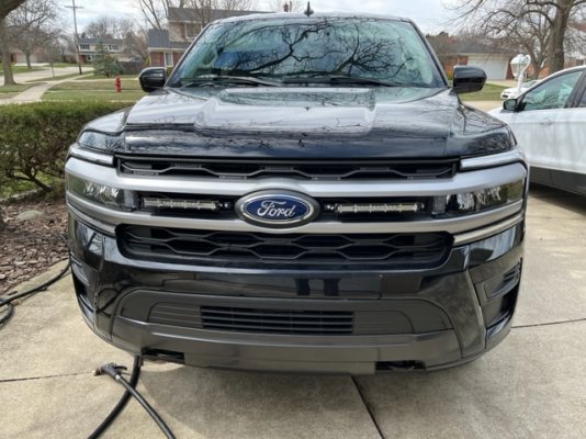

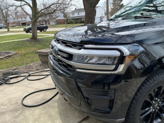

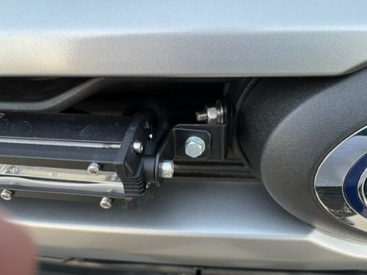

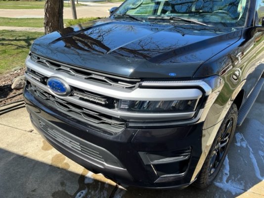

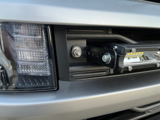

added front auxiliary LED lamps to the front grille with the ford Aeroskin. I hope to add a larger LED down low when I can find a solid way to mount it. Last summer I added the rear work lamps to the rear.

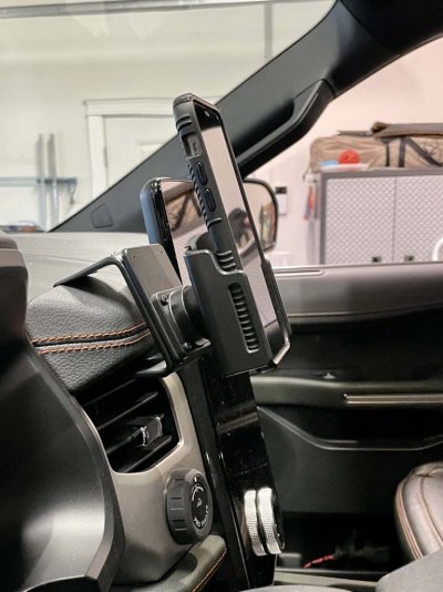

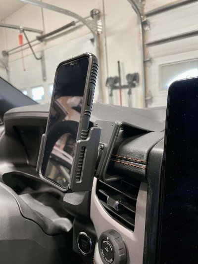

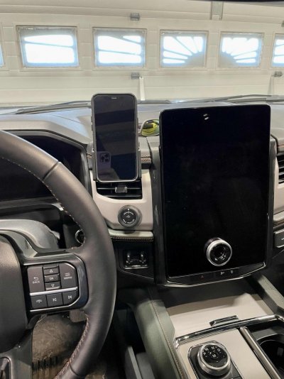

I added a ProClip phone dash mount.

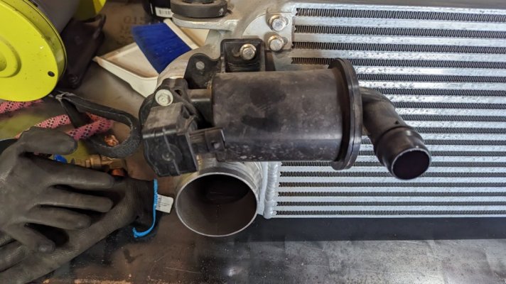

Pulled this old puppy out and matched my Mishimoto IC with a TurboSmart Veesport vent to atmosphere blowoff valve. Was a little worried about the sound but I can say I love it. Really helps you recognize the power (not in an HP or torque way) of the turbos and just how much air they move. I'm not expecting any real gains, but I wanted to help the turbo surge, and so far I think it's has.
A couple notes. I chose this one because it's plug and play, and also because they actually have a true plug for the standard in system release pipe. Some of the blow off valves out there don't have anything to plug that, they sort of leave it up to you. And I will say, the construction of this unit was awesome. The plug was even bill billet aluminum, which to me is just a sign of good quality. They could have easily handed you some sort of plastic cap to do the same job. Very impressed so far.
Built for anyone else that tries this, I ended up having to use half of the bracket that the blow off valve comes with, and the original bracket from the factory blow off unit. My guess this is some sort of difference between the f-150s and this platform. I would have blamed my intercooler, except the fact that the factory blow off unit directly bolted to that

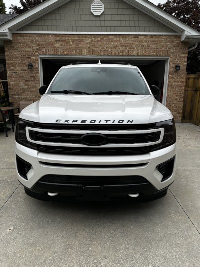

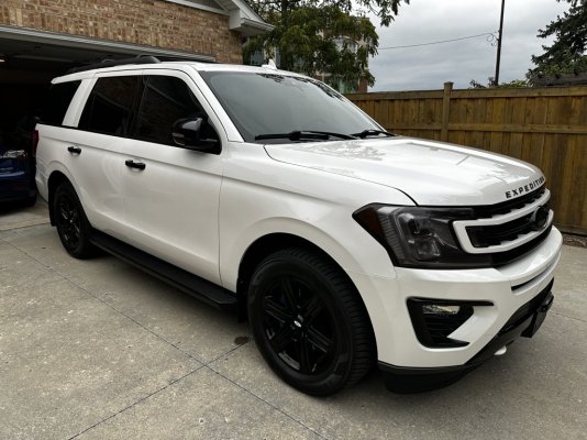

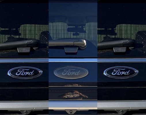

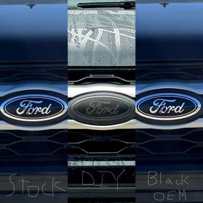

After having my DIY spray painted emblems on the front grille for 6 months and subjecting them to the Texas Highways (always under construction) they haven’t held up as great as I had hoped. So I replaced them with the OEM ‘23 Timberline Black and Chrome Emblems. I am happy with how they look as the colors I originally chose with my DIY emblems didn’t quite match what I had imagined. Note: it’s difficult to see the difference between the Stock Blue Oval vs. the Timberline Black emblems but in person they are completely different and look 100% better.
@winksskazam How did you buy these emblems? I’ve been looking to buy these!

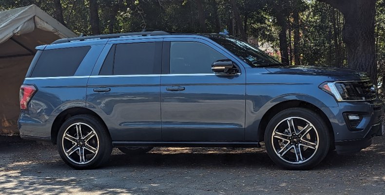

What I did with my gen4 Expedition this week? I bought it night before last, and drove it home!
past that its been reading the owners manual and checking things out. flash updating the sync3, doing a master reset and reprogramming stuff, etc.

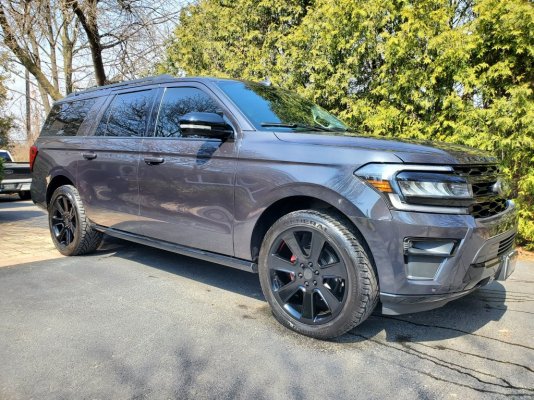

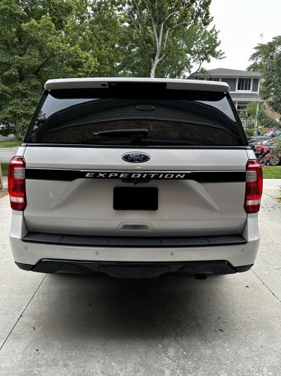

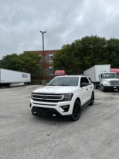

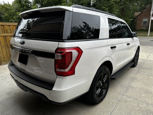

New to me 2019 Expedition XLT
Painted front grill black and body color
Chrome delete + Gloss black side mirrors and door handles
White Expedition emblem on the tailgate
Stealth Expedition lettering on hood
Removed XLT emblem on tailgate
Powdercoat 20” stock wheels in gloss black
New Pirelli Scorpion WeatherActive tires
Caliper covers in Electric Blue (the color of my first car, a MINI Cooper S)
Weathertech mudflaps
Weathertech scratch protection
Tuxmats on all three rows
Half safe for center console
All new speakers plus 18 inch subwoofer and amp
Catalytic converter shield
LEDs for all exterior lights
Tints all around
Medium tint on headlights (which have since been removed —dimmed the lights more than I expected)
Next on the list:
Painted Ford emblems front and rear
Rear view mirror camera
Custom black paint on taillights
Black out headlights and demon eyes
Touch-up paint on bumpers
Love the car and love that I’m making it everything I’ve wanted!IMG_2117.jpegIMG_2124.jpeg
