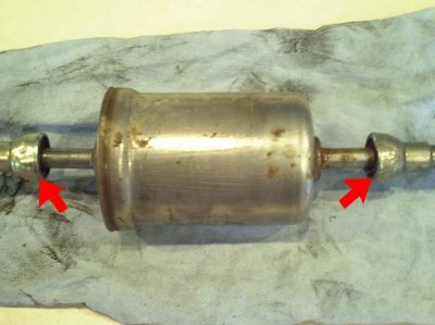

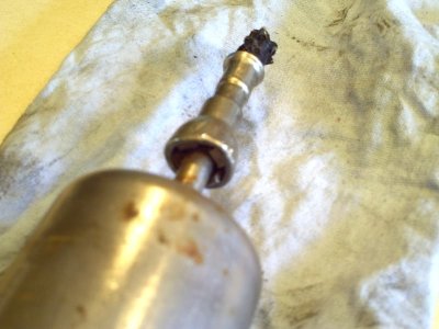

If you want to play mechanic and install a fuel filter yourself or change your own damn oil...
1. DONT PUT YOUR F'ing pliers on the quick connects...
2. And for god fu$king sakes, don't install the fuel filter backwards!!! $hit! I could give this previous owner a wedgie!... (Some guy named rodriguez it says on the title)
Yo, Rodriguez!, the F'ing "FLOW" symbol on the filter is supposed to point "downstream"... OR for you f'ing noobs, --- that means toward the front of your car!... GAS GOES FROM THE TANK TO YOUR MOTOR...
FUC$! -- ANOTHER previous "carowner special"....

It was the fact that I had to cut the filter out and splice new connectors in... BUT, while doing this (which I already knew I had to do), I noticed the filter was installed backward which "could" be the reason the fuel pump went out and also the reason the car had 'the shakes' and all kinds of other 'issues' I've been chasing all over the place!...
The stuff that completely ****** you off. You know?
no leaks! and shakes are gone...
Brakes now anyone?
