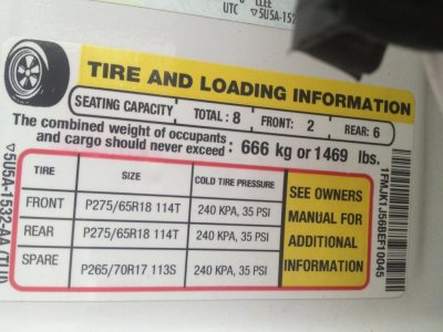

Gotta remember that the truck platform utilizes the leaf springs out back where the Expy is using IRS. Put some weight on the Ex and there is more squat side to side with the weight bring supported by coils. On the truck, leafs and solid axel supports the weight. Now to cloud the waters further, you can get an Ex with an optional rear leveling air suspension to help in the towing duties.
As far as payload capacities across the Ex line, mid 1500's to low 1600 is the best you're gonna get. 2 adults and 3 kiddos and gear and you should be fine, there's wiggle room there.
For what you are considering with the TT, the EL with rear air leveling and HD tow is the animal....good luck finding one. Still gonna max it out though
