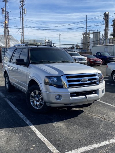

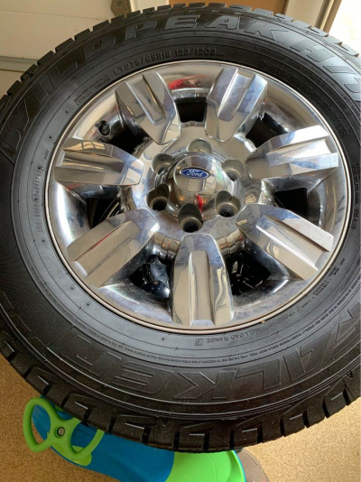

Hello all, I'm trying to downsize from 20-inch to 18 and wonder if these wheels gonna be suitable for mine before I buy them, I think they came off of an F-150 and I've seen some threads mentioned their TPMS sensors won't work with ours. Please excuse me for being a total buffoon for asking this question, thank you kindly.

Anyways, I've seen pics of 18's on 3rd Gen Expy's, so they will fit in general.
However, some of the posts I've seen about this says that if they're off an F150, the offset & hub length might be a little different, so you may need some spacers or have to trim off the back of the center caps by about 1/8".
And yea, you will probably need new TPMS's too, and probably need to change some settings in the ECU to account for the different diameter & weight, so that it gives you an accurate speed reading & can interface correctly with the ABS module...
