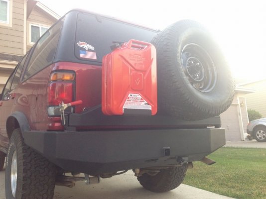

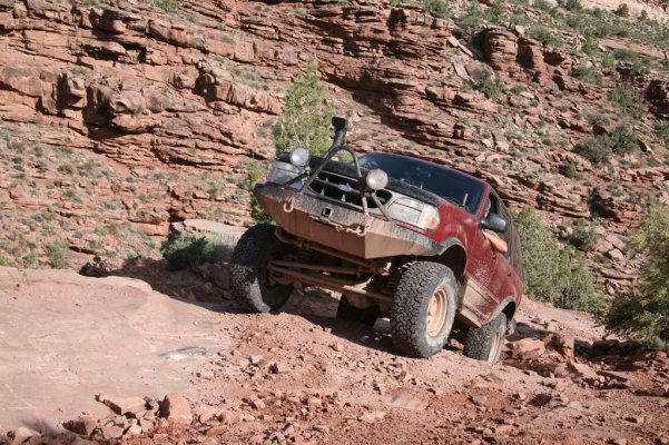

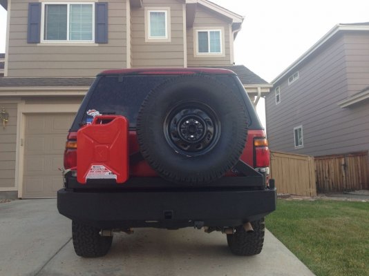

Solid 2x2 stock with 1/4" plate? It's gonna be heavy.
The bumper on my Explorer is mostly 3/16" plate and it's pretty heavy- but stout. I smashed it into a rock in the trail this weekend and it's fine. I just need to break out the rattle can to touch up the paint.

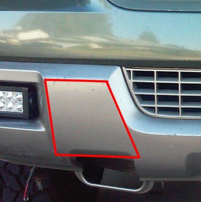

Thank you for the reply ExplorerTom. I plan on fabbing a front bumper like yours in the future (My kids bought me a stick/tig welder - plasma cutter for my birthday) but for now, the beefy pre-bumper will have to do.
I've decided the best course of action will be to use the 1/4 sheet to make a 'U-saddle' that wraps around three sides of the frame where the whole thing will bolt up to the tow hook mounts so that it won't simply bend or shift at impact. Then the 2x2 square stock will be welded to the 1/4" sheet as it extends forward of the tow hook area with two 1/4 impact points made/bent/beveled to match the two flat areas on the front of the plastic.
