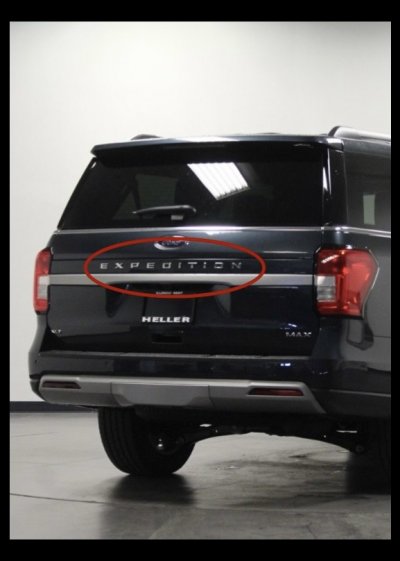

Does anyone know if those letters have pegs / holes in the metal? Or are they just 3M’d on. Thanks

What’s the first thing wife says on her new car… Can we remove the “Expedition” lettering? She thinks it looks weird.
Brings me back to my childhood days of debadging my WRX.
Sooo. Does anyone know if those letters have pegs / holes in the metal? Or are they just 3M’d on. Thanks

I concur with SyndicateZ they are probably 3m'd on. It's most likely been decades since manufactured pinned-on logos/badges or those done by dealerships (before decals). If the wife might feel better about it you could possibly black them out. An inexpensive way is with Tester's model paint and an artist's brush. Simply a thought... Best of luck!

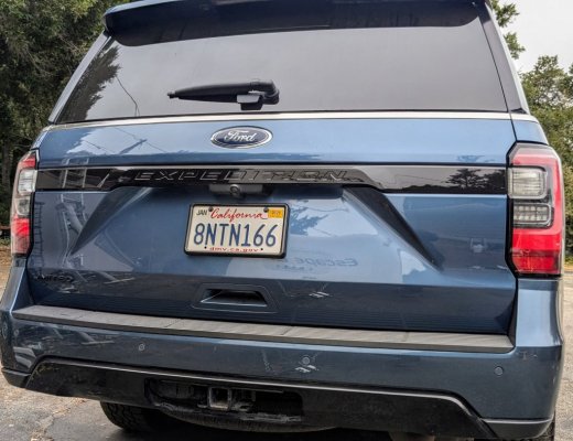

huh, what year is that? My 2019 has the letters molded into a plastic trim strip.
(its a stealth, so its black... that whole strip was brushed chrome on the 2019ish non-stealths)

But anyways, even on my slightly older vehicles (2015 & 2017) the badges/letters/trim are 3M'd on, so removing them would probably be difficult and leave some unwanted traces that would be detrimental to the resale/trade-in value later on...
PSA: a few years ago, a friend of mine acquired some of the same 3M double sided tape that they make specifically for the car mfgrs (the real stuff, not the cheap knock-off crap), and used some small strips to adhere his address numbers to his new brick house, just above his mailbox.... after about 5 years of wind, sun, snow, rain, low & high temps etc, we had to use a chemical solvent (Acetone) and a pry bar to get them off to replace them with new ones...
So that would not be doable for a car, just sayin :D

I pulled the dealer's badge off our Mazda with Goo Gone and dental floss if I remember correctly. These days I don't have that kind of aimless ambition.

put a heat gun on each letter you are about to remove. Do not over heat it tho. The heat helps "loosen" the adhesive and makes it easier to remove or cut through with a line. The heat gun has made it alot easier for me to remove badges

Lots of good and interesting advice so far hahah.
The good - just taped on, so if I really wanted to remove I could. I’ll probably just paint them black.
