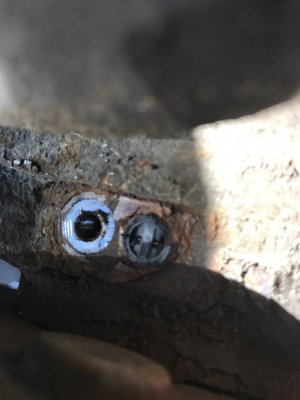

Also was not aware the wheel speed sensors are not replaceable. Me and my buddy broke both off in the bearings heading to ford now to get so new bearings.
Edit: they were just rusted into place drive screws into them and wack it will break apart then pick pieces out. Thought I should try that before buying bearings
