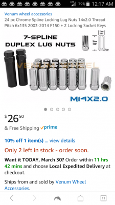

By sheer coincidence, the very next day after reading this, I met with the very shear-off lug nuts described herein when procuring some used alloys (SSV steelies use a far more durable acorn design)
Ended up buying these cheapie pseudo-wheel-locks, got two sets black and chrome cuz I wasnt sure - prolly gonna return the black, kinda like the chrome with blacked out wheels... NOTE: black held up OK to being impacted on and off though, I just like the chrome a bit more
...or is it bad karma to return a product you've used an impact on, even if it looks fine?
