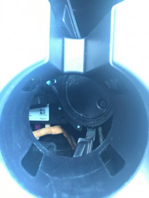

My 2018 Expy has been flawless until today!
One of my cupholders fell down through the console. Now all I have is a big hole with the guts of the cupholder below it rattling around. I tried to repair it but no way. Can't get down in the hole to retrieve the parts...there are many of them.
I have the best Ford OEM Expended Warranty offered. Do you think this will be covered????

Had the same thing happen. The design / construction is wimpy, I'm surprised this is not a widespread issue.
Video are online about how the entire console top lifts off it's retainers so you can access the cupholders. I repaired them, using Gorilla Glue. So far, so good.

This just happened to my 2018 last night. I went to put a water bottle in the cupholder and the whole thing collapsed into the console. I’m still under warranty so hopefully covered. What a terrible design this is.

Has anyone been able to repair this? I took it to the dealer and they wouldn't warranty it through my Ford extended warranty even though I bought the best one they offered.

Did your warranty cover this??? I am still under warranty with my 2019. Just wondering before I try to to fix myself

Seriously looks like an idiotic design. Why move away from the molded units that virtually all other vehicles have. This seems like a great way for a large amount of liquid to end up in there. I'm thinking Styrofoam cup ends up crumbling when this fails...would be an awful mess.

buy a new console
Not super helpful. are you talking about some kind of aftermarket console? or a whole new factory console? I actually hope neither, given that just the cup holder is $150, that would tell me the console with all parts is at least a grand. I'm still curious how the repair was. And yes, what a piece of crap design, shows that many systems inside and out are likely untested for real world use before heavy manufacturing begins.
