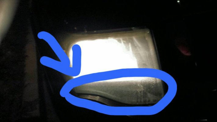

My right headlight has been collecting moisture for a while now but it hadn't been anything major until now. About 6 days ago, when had a bad rain storm that last about 2 days. A day or 2 after it ended, I noticed that the passengers side light had collected water about 20 to 25% up [covered the whole bottom turn signal light].
So I got the water emptied out amd let it dry the best I could but today I noticed that the light isnt working properly.
The actual blinker light STILL works [blinks], but the running light [amber light?] Doesnt turn on like on the drivers side and the reflector/light on the side of the lense is out as well [see pics].
Passengers side:
Front of light [Still blinks/flashes]
Side of light
Drivers side:
Front of light
Side of light
I'm sure this is related to the water, but could it just mean that these bulbs just need replace, or could the damage be more serious?
Im going to replace both lenses in the next week or so because of the moisture issue and because of haze of the lense, but I was to make sure there arent any electrical problems b4 I do.
I also see some amber colored shards in the bottom of the lens. I dont know if a bulb bursted, or if its colored coating from the light itself. Will try to get a pic of that during the day.

Replace your bulbs when you change your lamps, they probably shorted due to the water. If they do not light up when you replace them then check your fuses. The amber bulbs seem to lose their coatig nowadays from the heat so that's why you see pieces of amber. Most non OEM housings are ok but can yellow really fast. You may want to look for used OEM on Ebay. If you are interested in getting rid of your current housings let me know. Good luck

Not sure which fuses, you would have to check your manual. The light on the side is a bulb, you will see it when you remove the headlamp. It is a 194 bulb. The blinker/parking lamp bulb is a dual filament bulb so one can work without the other. You can remove your headlamp very easily in a minute. Remove the two 10mm bolts on top, lift the top plastic up a bit to clear the clip, and grasp and pull the headlamp from the bottom and pull straight out. There are 2 clips that hold the headlight in the rear. Turn all the bulb harnesses counterclockwise to remove them from the headlight.

Ok so it was the bulbs... that was easy!
