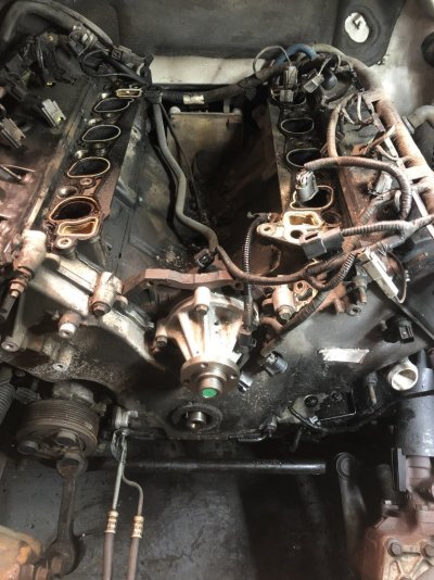

I got it back on.. Only have it torqued down a bit..You can read the torque sequence below which is two stages.. But, the instructions installing the thermostat, calls for 18lb/ft .. I would think that would be uneven.. Is this an error in the manual or is this the way you do it?

I guess I will torque to 89lbs/inches on everything like it says, then re torqe the thermostat to 18 ft#

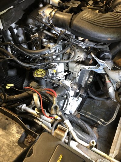

Finally went to turn her over, and nothing.. Battery voltage was good, but load test was not good.. So..
Anyway, I have things setup to flush the engine block, before hooking the radiator up..Also, if I need to step back in the compartment to reach something..

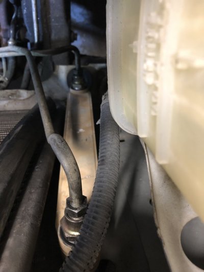

I took the transmission cooler out of the old radiator, to temporary run the engine.. I was shocked how small it was.. I wonder what size, or what type a one with trailer towing package looks like?
Billme
Billme
Oct 16, 2020
320
131
Hattiesburg,Ms
All I have is power steering cooler in front.. I may look at upgrading this feature.. The one inside the radiator is puny

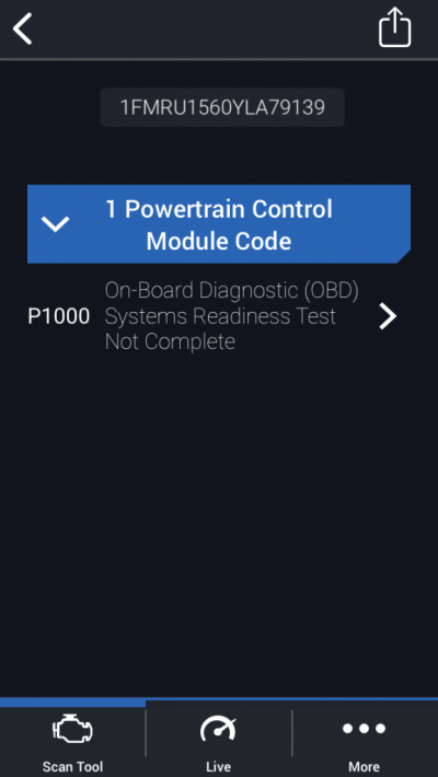

I was going to follow makoloco procedure on turning the engine over with just the start until the oil pressure gauge came up..
Does this year (2000 xlt4.6 ) require all sensors to be connected?
