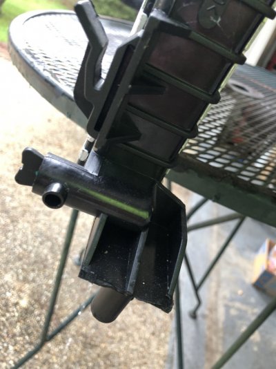

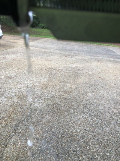

The leak is coming from the compressed seam.. Some compression fingers look tighter than others..
It’s obvious no one tested this radiator at FPV..There was no indication on the box for any damage.. I’m very disappointed.. It’s been sitting in the shop till I got ready for it.. Several months.. They advertise limited life time warranty.. I dread letting Rock Auto computer AI to do something about this.. May have to go straight to the manufacturer..

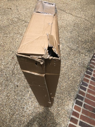

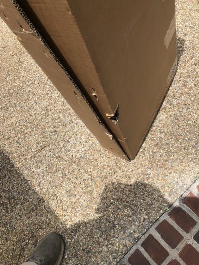

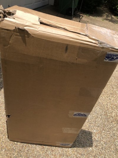

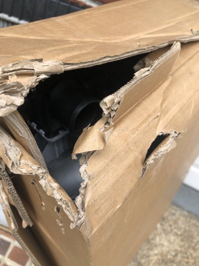

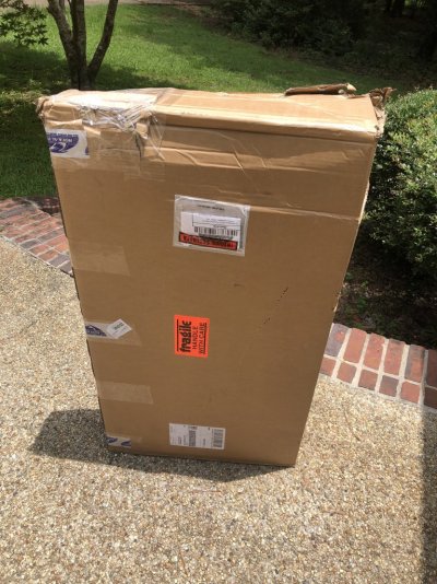

Second attempt to get a radiator doesn’t look good.. Fedx just delivered it.. I can’t believe this, I can see the radiator without opening the box.. looks as if someone after shipping tried to fix this..
Should I go ahead and open it, and see if it will hold water?

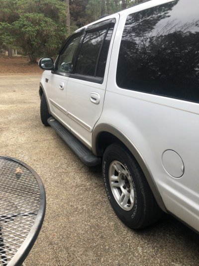

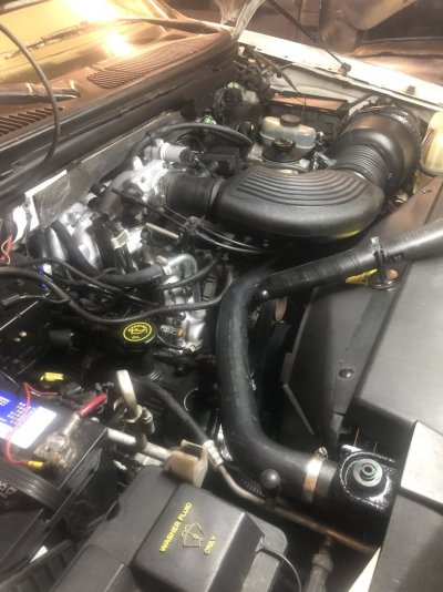

New radiator works.. Have a few miles on it now.. Had a problem with an injector, but tapped on it a few times and the motor is smooth now. Maybe massaging these injectors periodically and noticing a slight difference may help with maintenance..

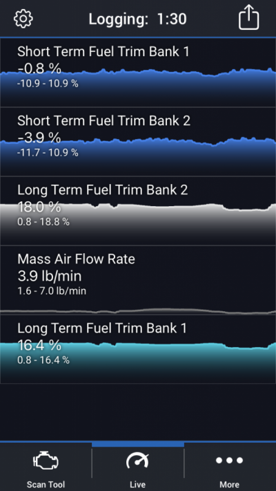

I put the 5w30 back in it, done the same trip, but at 65 mph and got 18.5 mpg..
I’m new to interpreting these fuel trim figures, but this was done at 65 mph
I’m not sure if the long term fuel trim is good, for this particular speed..IMG_6408.png

Nice work, impressive MPG! Long time ago my 1999 5.4 got around 14 mpg city but now it's down to 11.5.
I wouldn't be concerned about those LTFT readings unless they're increasing; they won't trigger a DTC(P0171,P0174) until well over 20%.

Thanks a bunch, I’ve been reading about it, but you told me what I need to know..
