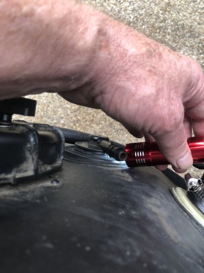

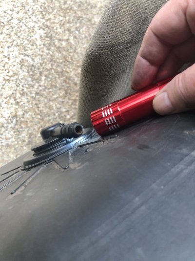

Ok, zoom in on these two pictures of the front and back vent valves.. They are actually check valves, checking toward the tank..
I’m wondering since both have the same looking crack, at the same place(what are the odds) if these are intentional..
The front seems to leak very slightly while no leak in the rear.. I wonder if it to allow the check to work properly..
Should I leave it alone, or cover with ultra black?

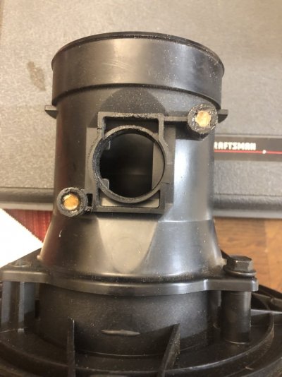

Got a mass airflow sensor.. The screws both snapped, so I’m waiting for the epoxy to cure, then put some screws in to hold the new sensor..
It’s a good fight..

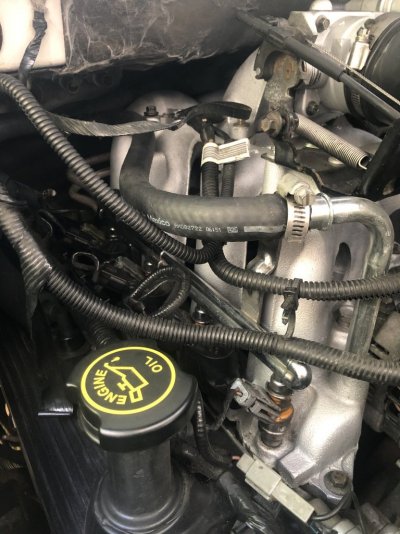

Put the old Idle control valve back on and this changed the rom back down to 1500..
I ran another smoke test on the intake, still didn’t see anything but I can hear it now.. Seems to be coming from the egr area, but I don’t feel, or hear a change when a spray around it..
This thing is whipping me.. It may be doing like the ICV gasket..I’m going to check that.. If that doesn’t do it, I’m pulling the intake, and getting a new one, or if I can get just the lower intake..
What I did notice this time on live data, longterm fuel, was negative numbers, where they use to run 8 to 10.. You can tell the engine is running lean, I would think the PCM would be adding fuel..
Is this a sign, the pcm is damaged.. I got another week before my professional mechanic can see it..
Damaged one bolt hole on the ICV, but was able to fix with a tap.. The story continues.. I hope I’m not boring you guys too much…

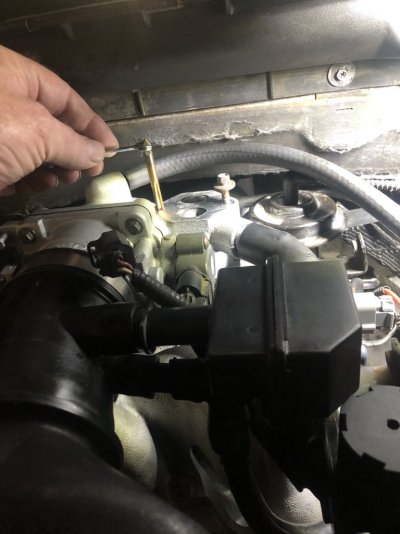

How the heck do you guys deal with that PCV vac hose in the back of the throttle body? Dang! I guess I’m going to have to take the TB off to check it… This was a new hose, but ….
Since I had to add another gasket to the ICV, I also may have to on the throttle body, and EGR valve..It’s really hard for me since I can’t step down in the motor area, like I did when doing the timing job..
