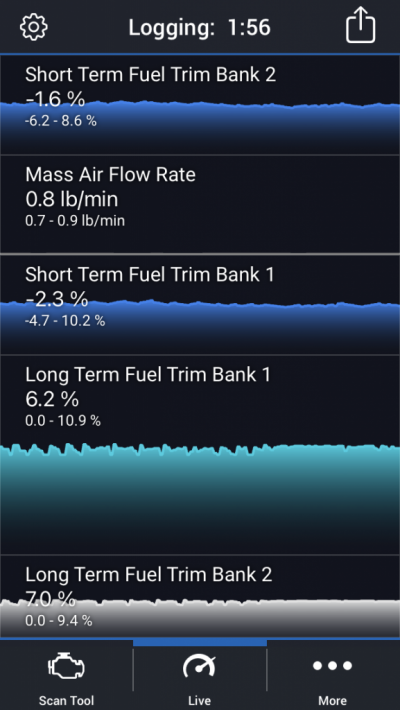

Well I’m confident it’s not a air leak on the engine.. I put a new throttle sensor and now have a reading that moves..
This problem is probably on the evap system on the fuel tank..I’m going to have to let my local guy look, when and if he ever gets caught up..
This thing cranks up normal, goes to 1200, and soon 1000rpm, then you hear a solenoid click, then it jump to 1500, then to 1100.. it’s perfectly timed intervals, and will gradually lower in rpm’s.. It eventually lands at 750 where it’s supposed to be..
The engine runs perfectly fine and smooth otherwise..
I’m not getting and engine light.. I did get a P1504.. changed out the solenoid, but it still does this ritual.. I did replace the vent valve, and while just after it started I open the gas tank cap, and it had a pretty good vacuum on it, indicating the vent valve was closed during the cycle..

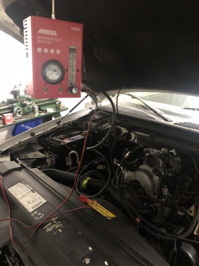

Well my smoke machine arrived, and still learning.. This thing is neat, although I didn’t know there are 3 models of Ancel 3000.. Of course I got the model that didn’t have the evap adapter..
Anyway, I’m breathing better since I didn’t see any smoke coming from the intake, thank goodness ..I may have not used the most flow to kinda pressurize it.. Still getting the feel..
I did hook it up on the evap vacuum supply line..no leaks, but I unhooked the vac line to the egr valve and it was pressurized.. I thought the EGR control solenoid is supposed to be closed .. Anyway, this is what I had a chance to do yesterday..

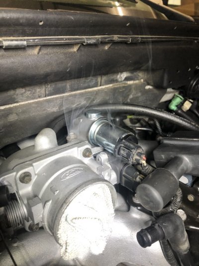

I found a big leak after cranking up the smoke.. The ICV seems to be leaking at the gasket.. When I fiirst took it off, during the timing job, I wondered why it had so many gaskets, now I see why..This was apparently a problem before..
It’s a new vac EGR control valve..I do have a vac gauge, and will check it.. I only checked voltage last time, and felt with my hand on the vac side
You can zoom in and clearly see the leak..
This machine is a must have!

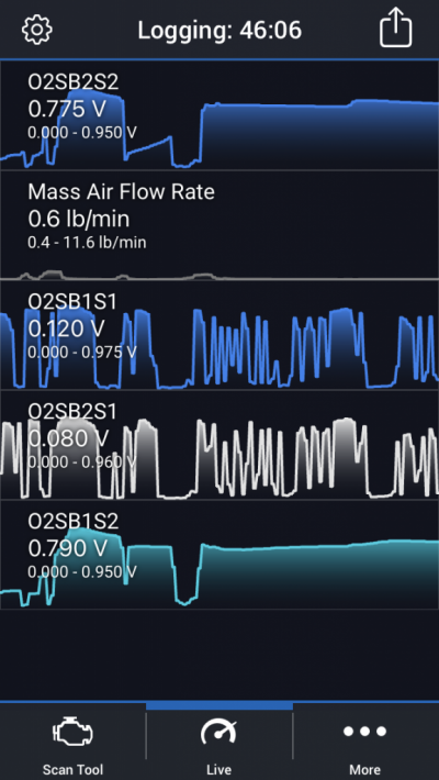

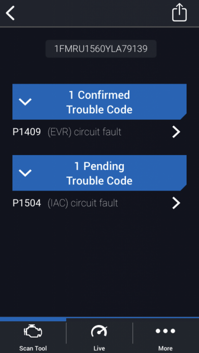

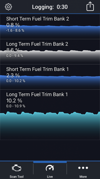

I did do a quick scan before ai shutdown this operation due to grandkids..
What the heck, this may have been caused when I unplugged them..

Didn’t make a change, except a few more rpm’s higher..During the changes, timing changed, it’s like someone is is just giving it throttle.. I’m wondering Two things, PCM bad, or the ground being mounted on the intake, instead of the back of the passenger side head is somehow maybe interfering with the electrical side..
After about 10 mins, it wouldn’t comeback on to idle, so I cut it off, and restarted..
It was if noting never happened..
Making my chest hurt

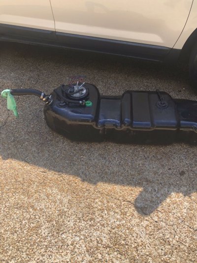

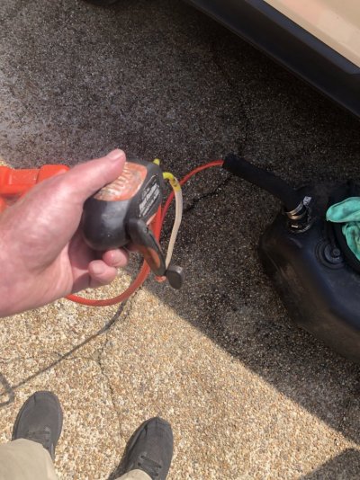

I was able to put smoke on fuel tank through the evap system.. leaks from the top of the tank, and around the canister..I’m to old to do this kinda work, so off to a pro ;)
I don’t know the testing logic between the evap system and the EGR operation..
I do know I first tested the voltage on the egr vac control valve Power and signal was 12.4.. I never did see the voltage drop on the signal side..So, I can assume the egr valve is not moving..I don’t see any vacuum to the egr during engine run..
Like I said, after about 10 mins everything settles out, then it starts acting up, for a few mins, then settles back down..I’m pretty sure this a vapor burning sequence..
Since I have so many leaks on fuel system vapor, would this cause, or upset the egr control logic?

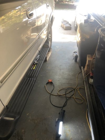

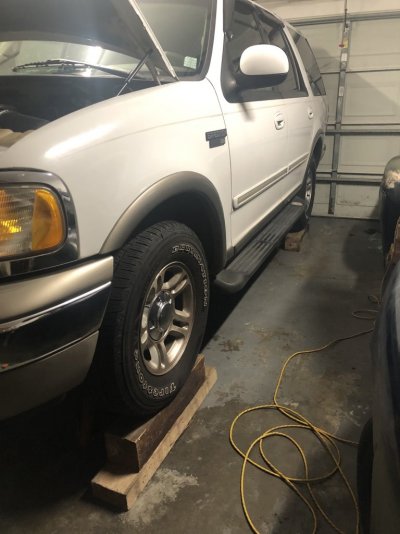

I decided to do it myself since it has cooled off a bit..Got to get in shape for that heater core job
It’s off the ground anyway..

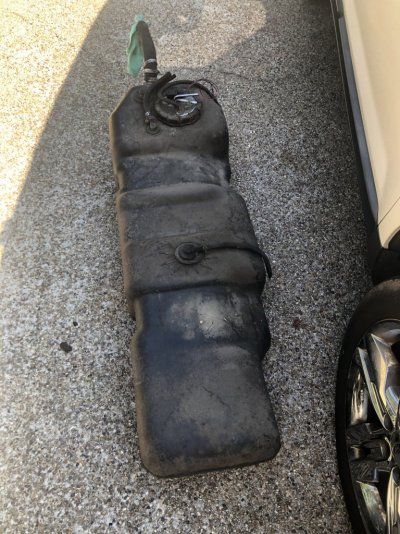

Billme
Billme
Oct 16, 2020
320
131
Hattiesburg,Ms
Well it’s out.. all the lines look bad..
Of course it was a good fight, but I’m learning..
Going to clean it up, and out, then treat the whole tank with ultimate black Maguires. It’s great for plastics and rubber..
I’m changing the pump also since it’s old and the key on pressure was below spec..
All the vapor lines will be replaced and canister..
I think I’m going to take it easy for a while, hehe
