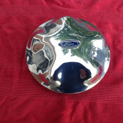

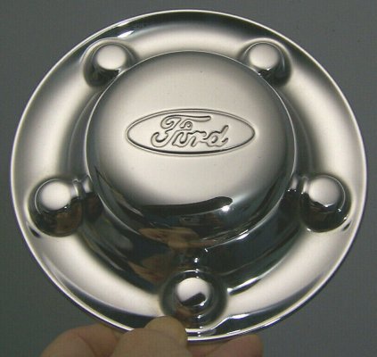

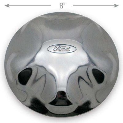

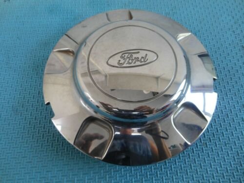

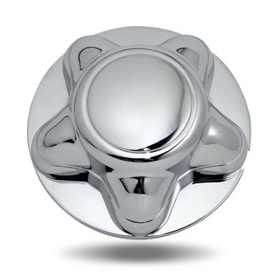

Here are some OEM caps I found on Flea-bay. You will also find some aftermarket in the OEM style. They all mount to the lug nuts. Keep in mind that lug sizes changed from 12mm lugs to 14mm lugs after 11/29/99 and thus I believe the caps should correspond to the lug size for most. This isn't always true, if your rotors were replaced with the wrong year, along with the corresponding lug nuts, you may have a mismatch, as I do on one of my Expys.
1997-2004 F150 Expedition center cap blue oval F65A -1A096 , F75A-1A096-DA F85A-1A096​
2000-2004 Ford Expedition and F150 Center Cap.
  • Manufacturer #: XL34-1A096 YL34-1A096
  • Interchange #: 03398
1997-2004 FORD F150 EXPEDITION OEM WHEEL CENTER HUB CAPS PART YL34-1A096-DA
99 00 01 02 Ford Expedition Wheel Center Cap factory YL14-1A096-AA XL14-1A096-BA
FORD Center Cap F150 2000 - 2004 Stainless Steel OEM # YL34-1A096-CB

Yeah, mine are this style in 14mm . I have to be sure to remove them before having mechanical work done at any garage because invariably they get broken by mechanics and then fly off in my rear view mirror on I4 days later. I bought replacements used and epoxied all the broken posts that hold the steel spring retainer on. I would like to find a flat disk to replace them, otherwise keep salvaging the OEM.
