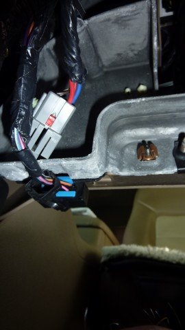

If the trailer has electric master cylinder brakes, you can add a brake controller to the Expy very easy. The brake controller plug is right there by the OBDII port under the driver's dash, about where your right knee would be. It's plug in play with most Hayes, or other aftermarket controllers.
Brake controller plug by OBDII port....

The 2003 Eddie Bauer has a connector just above the gas pedal to hook up a brake controller. My EB Bauer came with the Towing Package so the 7 pin connector at the hitch was installed. As for the connectors, I am not sure, but I would think they are part of your harness. I don't think they had different harnesses, just the connector and transmission cooler.
