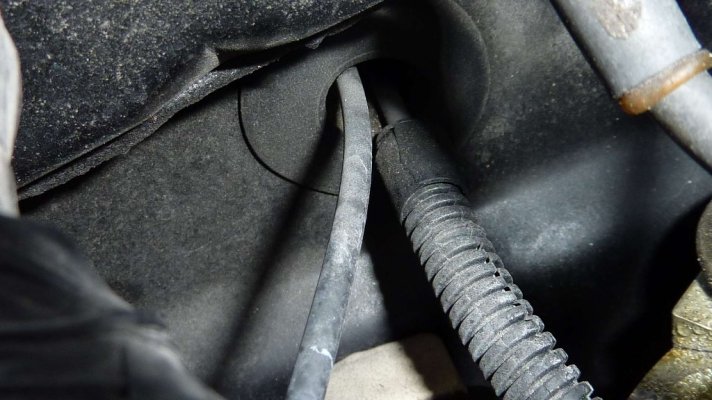

Check vacuum line going into the firewall just below the PCM . If there's no vacuum to the control solenoid under the dash the front vent control won't work properly.

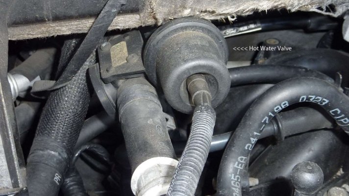

Make sure the vacuum line is attached to the hot water valve....
Vacuum supply line firewall pass-thru grommet ....sheathed line is from hot water valve, unsheathed line is supply line from intake manifold ....

Check the vacuum line carefully it’s likely broken. You might have to remove the battery & battery tray to get more room to work. Please note the vacuum line also supply vacuum to the 4x4 switch and there is a one way valve on the line. Make sure the 4x4 is NOT engaging if the line is broken when the engine is ON and it’s in 2H .. Jack the front wheels up and spin the wheel. It should turn freely without the axle turning when the engine is OFF and When the engine is ON in 2H

If the floor vents are still pushing air, look for broken/deteriorated vacuum hose at the firewall right behind the battery. You will probably have to remove the battery to see it.
