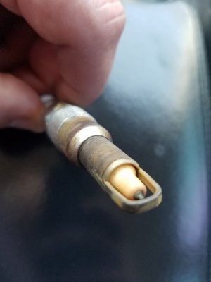

2007 Ford Expedition Engine popping loud, please help?
C
chris2888
Apr 23, 2016
24
TN
I have 182k miles on the vehicle. The engine is still very strong, idles perfectly and is quiet, exception when pulling grade.
1955moose
Nov 23, 2014
5,981
1,338
Chris, get the codes read, and posted. The fact that you have strong power, and smooth idle rules out catalytic converters, coils, plugs, fuel delivery. After running codes, report your findings so we here can narrow down your problem.
6,510
3,124
It's tough to know to be honest. When my COP on cyliner #8 shorted due to water my truck had a misfire in Overdrive as well, if I took it out of overdrive it stopped. When we pulled the plug at the shop it was completely shot from not firing correctly and all my plugs were relatively new... it's hard to know because just because we replaced parts a year ago doesn't mean anything these days. All you can do is get the codes and get a diagnosis..... it's not the old days where it was easy to diagnose our vehicles.
C
chris2888
Apr 23, 2016
24
TN
I hear ya. These newer ones are a bear to diagnose. I will get the codes read here in a couple hours and post them back here.
Thanks,
C
chris2888
Apr 23, 2016
24
TN
So I ran codes, here is what it came up with as the only code. P0430 Generic. Catalyst System Efficiency Below Threshold (Bank 2) - Wouldn't that be an oxygen sensor on the passenger side? Not sure if that would have anything to do with my problem.
Thoughts?
6,510
3,124
Thoughts?
Well the oxygen sensors tell your vehicle how to burn the mixture at all times and in all sorts of situations from what they receive from upstream so if they aren't functioning right they can cause all sorts of problems. I googled your symptoms and some had a catylitic converter going bad. Obviously I'd try the 02 first...
C
chris2888
Apr 23, 2016
24
TN
I appreciate the help here. Would not have thought the O2 or Converter would cause such spark knock or detonation. Maybe replacing the O2 sensor will correct it.
Boose
2017 Platinum EL
Mar 18, 2014
319
101
NJ
Is it possible it's going lean when the power is needed? That will absolutely cause a pop.
Habbibie
Is it Christmas yet?
Feb 2, 2016
1,854
564
Chicago
Just a head up bank 2 is the driver side not the passenger
C
chris2888
Apr 23, 2016
24
TN
Thank you both. I will replace the 02 sensor on the Driver side to see if that will fix the issue.
If anyone can think of anything else here is the plan over the next couple days.
Carbon removal
02 replacement on Drivers Side
Cleaned the MAF- do u guys suggest to go ahead and get a new one?
Thanks
