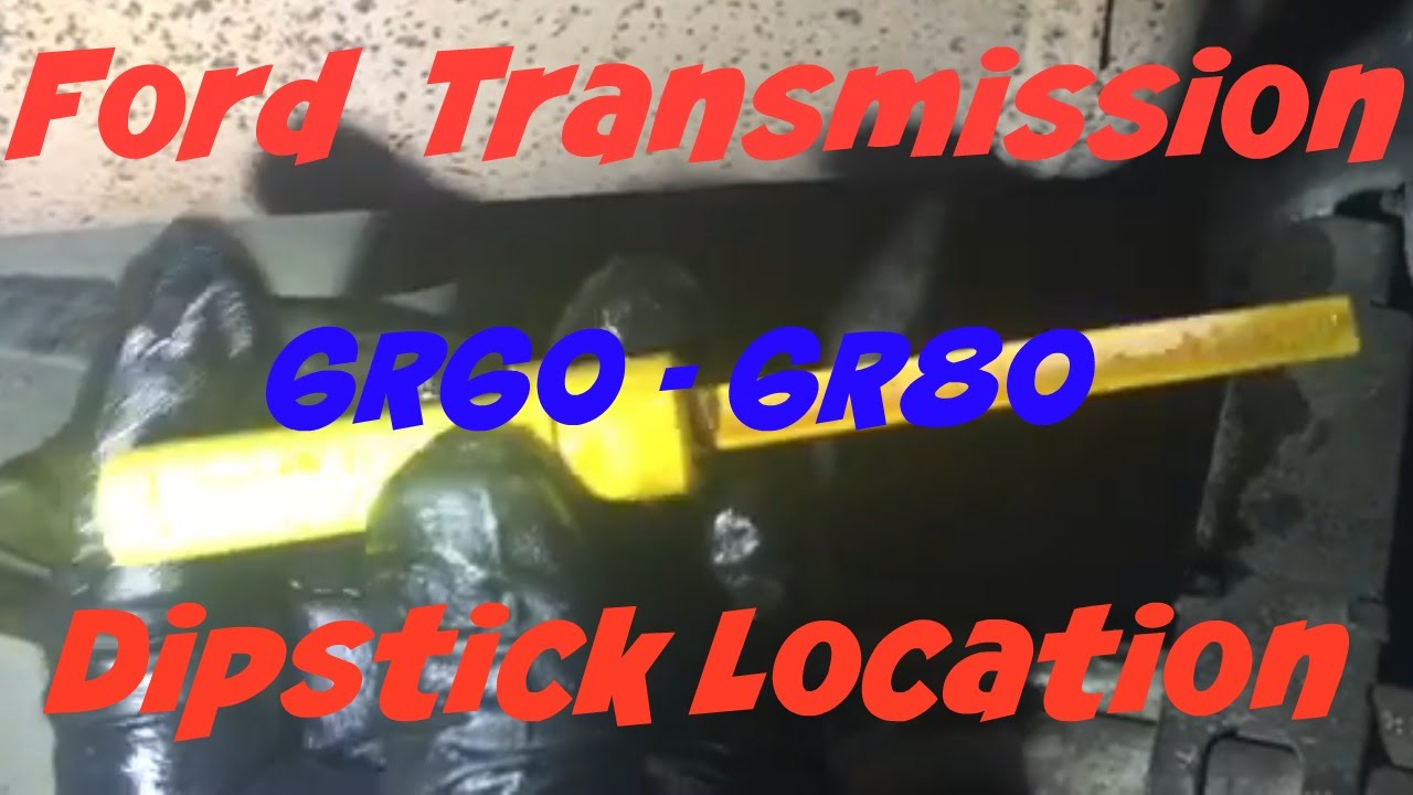

I believe you have the same 6r80 transmission as mine, which means the dipstick is under the truck on the passenger side above the transmission pan. You need to remove the cap and it comes out with the cap.
