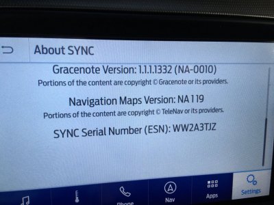

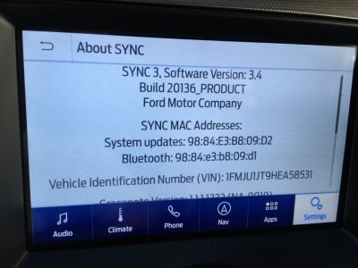

You're happy with maps 5 years out of date? :) When I upgraded from 2.2 to 3.something last year I got more recent maps and some added features -- including the ability to use the navigation feature when driving.
The upgrade from 2.2 to 3.x adds lots of features and 3.4 20136 is the latest version.
I think you can just do the CyanLab upgrade. Just follow the instructions and make a clean USB file. Two USB drives make is more convenient than just one. 32G is what I used.
See my notes in earlier messages. Note this was a clean install for me and there was no saved destinations, etc. in the nav system when done and I had to relink my phone.
Note my map edition below.
-- Chuck

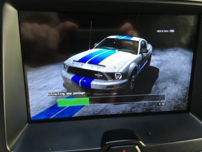

chuck s
Dec 20, 2006
1,990
753
It takes about 45 minutes to update the system. 10 minutes ain't enough time.
I started with a newly formatted 32G USB drive and pulled it from the PC when instructed, then plugged it in the lower socket in the center console with the truck already running. Chip was detected and the upgrade started with no intervention from me. Came back 40 minutes later and it was done.
Did you get any screens like this?
-- Chuck
