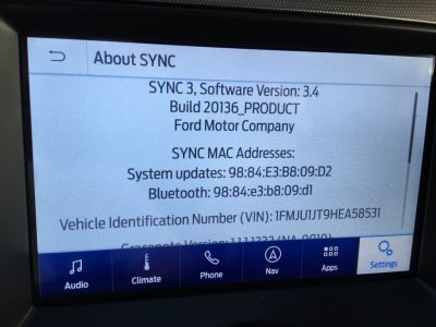

The CyanLabs software is downloading in the background. Now I gotta figure out how to just update the maps. I'm already on 3.4-19274 with the 0118 maps.

Chuck, You can’t. In order to update the Maps you have to do the format step. It has to do with how the Maps are licensed. Since you are running 19274, you have to downgrade to 19200, then run the format tool, then load the newest.

You would get the new Maps(19). Since you are on 19200, you just need format, then newest install.
20136 is stable. At least that I have seen so far.

1. Download and install 19200.
2. Download and install 20136.
Gotta wait for a cool morning.

I let it run. The downgrade takes 10 minutes. Format 1-2, but the install of 20136 with 19 Maps takes a bit.

You need one (1) USB card. I used a 32G version. If you have two (2) it's more convenient as it will save some waiting.
Go to CyanLabs.net, download the new installer, run it and follow the prompts. You'll need some information from your Sync system if, like me, you did this last Fall or this Spring as the latest version from that upgrade won't work so you need to "down grade" first, then "up grade" with the latest version.
1. Install the down grade on the USB drive. Take it to the truck and with the engine running insert it in the USB port inside the glove compartment. Bottom port worked for me. Watch for the display of "Upgrading System" or similar on the panel. Come back in 15 minutes and wait a couple for the "Remove USB drive" prompt.
2. While waiting for #1 to install go back to the CyanLabs software that's probably still on your PC screen and down load the revision you want. Select 0119 maps, the latest. Install this on a second 32G USB drive and when this is done go back to the truck where the first install should be done.
You can reuse the first USB drive, just less convenient.
No separate Reformat, that's all in the second download.
I turned the truck Off and then back on, then inserted the new update USB drive. This takes nearly 40 minutes. Done.
