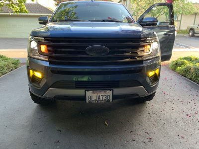

2019 Expy XLT halogen to led swap.

I wonder if they do the switchback option. I'd also be worried about those possibly melting the plug harness. I will look into them though. Thanks!

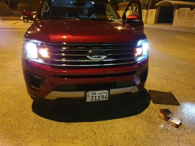

I wish I would have took a picture of what they looked like installed. Really is cool how they are white while the car is on, then turn the white off and go to amber for the turn signals. Makes the front really look good. The funny thing also, the bulb flashed normal, it was only the interior signal that was flashing fast. Once they get the forscan codes, all we have to do is turn off the code.

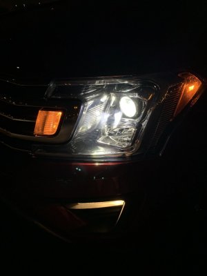

Added my LED fogs and low beams. I haven’t had a chance to drive around at night and see the difference yet though.

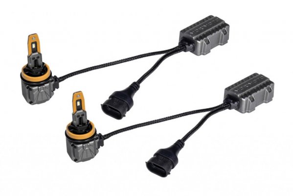

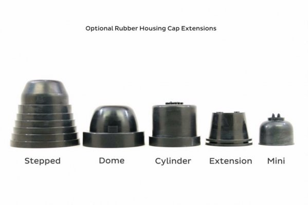

I see Morimoto recently released the 2Stroke 4.0 and they say since the low beams are used as DRL's, you will need the anti-flicker harnesses. I am really interested in upgrading my front end lighting with these, but do have concerns with everything fitting in the housings. Can you show us how you fit these? Did you get a deeper dust cap? Do you know the shape and size? THANK YOU!!!

I have the Morimoto 3.0's. I upgraded just before the 4's came out, but they're pretty much the same other than the improved chip mounting area. I had the low beams as DRL's for a short while and had no issues. I'm not sure if I even noticed a flicker. I have since reprogrammed via FORScan for my fogs to be DRL's.
Otherwise they fit fine behind the factory cap (Hi & Lo).
