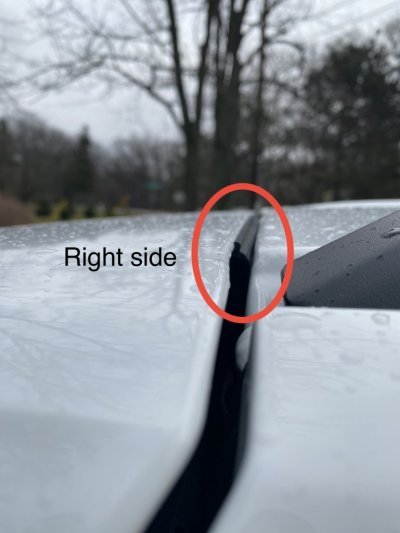

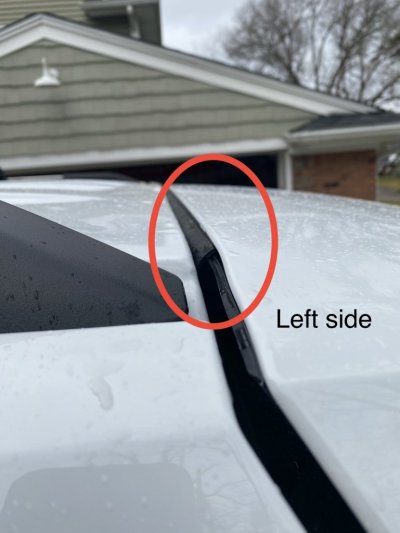

i have a 22 xlt manual tailgate and it has the problem with the tailgate when there is ice . I have not damaged it yet but I have to pour hot water on the upper seam when there is Ice or the gate wont open more than about an inch. It appears that the center area of the plastic spoiler is slightly lower than the surface of the roof. With the close tolerance of tailgate to roof it appears to create a ice jam.

same problem in a 2022 Platinum - hit the open hatch botton on remote and some horrible sounds - didn't see anything wrong until driving on the highway a couple weeks later and kept hearing strange sounds - read this thread and looked on top of the spoiler and i have the same issues - cracked and a hole in my roof - pissed because this will be a long term problem due to design and I know Ford will try not to cover it

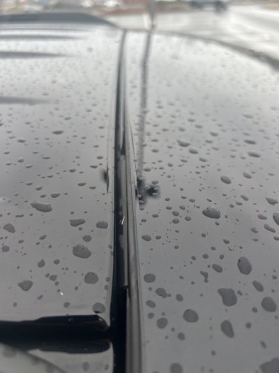

I have a 2022 Expedition Platinum and had the same issue twice in December. I used the remote to open the lift gate in cold weather (10-20 degrees) and the rear spoiler rides over the roof on one side and where it hits the roof I have the same damage. The dealership I purchased the vehicle from would not submit claim to Ford because the Service Manager didn't believe the plastic spoiler could damage the roof. I you could forward info on the warranty claim that Ford is honoring it could help my case.

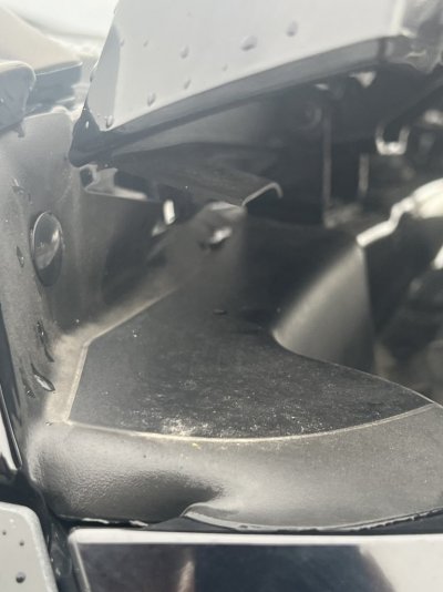

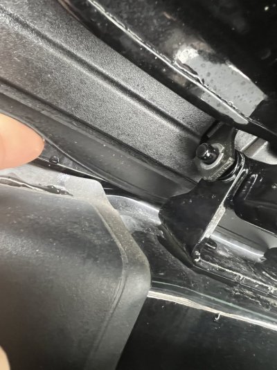

From what I can tell this part didn't change for the refresh after checking the parts website for multiple years. I wonder what has changed since there didn't seem to be previous complaints on this that I've seen. Is the spoiler gap adjustable during install of the spoiler and it is being set too close so when water gets in there and freezes it expands to where it hits the roof when opening? It looks like that rubber gasket under the gap will allow water to freeze in there.
For those with damage, when were your vehicles built? This info is located on the driver's door sticker above the tire and loading sticker (where the VIN is). Maybe these were all in the same timeframe which could lead to someone installing them incorrectly from the factory or maybe a supplier issue.
