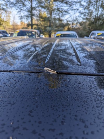

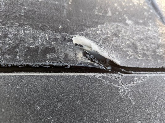

I took some additional photos tonight in dim light. It really highlighted the damage and shows consistency with the other photos here, down to the ripple left of the puncture. The rear spoiler has become dislodged somewhere and is binding on the body in the exact location of the damage. No damage is evident when the rear hatch is closed. Nothing appears to be out of place or misaligned.
Patching the hole for now with some knockoff duct tape. The body shop can’t get us in until February 1st.
Until then I will continue to pursue a warranty claim with Ford. Please update this thread with details and photos if you discover similar damage to your vehicle!
