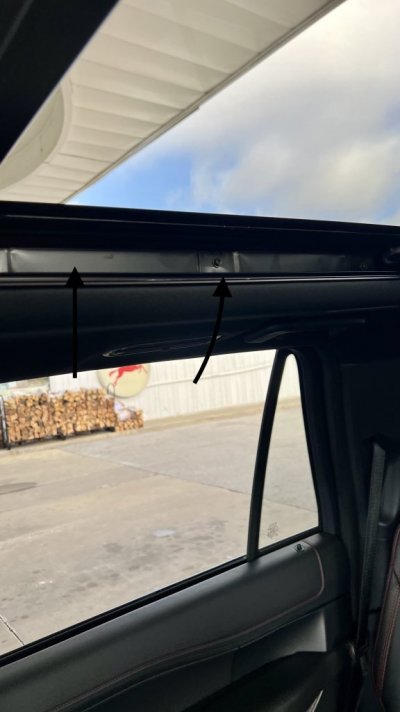

Sunroof cover was rattling (more when fully open) and was able to convince dealer. Per dealer RO "lowered the headliner, Placed anti-rattle tape at the base for where the magnet sits on the crossmember". Seems to have solved the problem. I am not certain if it always looked like the attached picture, but when I inspected I could see bolts and exposed framing... Can anyone please tell me if their new expedition looks like this when the cover is open or did dealer leave something off when they finished the job?4BA0563F-1CBC-4A3E-ABCF-70A0DCF3821F_1_201_a.jpeg

My sunroof looks the same (2023 Timberline), so the dealership didn’t leave anything off. The bolts you are pointing to are the adjustment bolts for the rear glass in the panoramic roof.

Same rattle on our 2018 Expedition. I traced it to the metal bolts that hold the glass pane to the frame. Torqued them and the rattle was gone. It took me about 5 months to figure this out.

I have a 2022 Expedition and has been rattling for over a year. The rattling sounds like it is coming from the sunroof. I will try and torque the bolts to fix. Thanks to R and N for suggestion.
