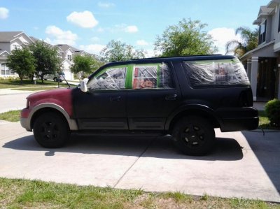

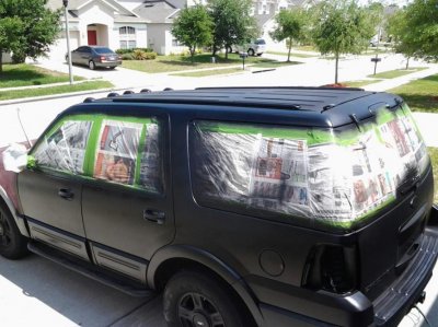

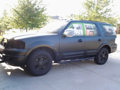

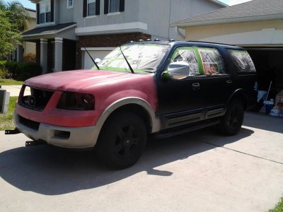

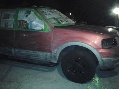

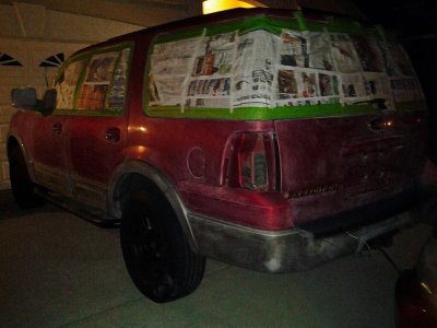

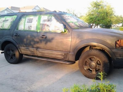

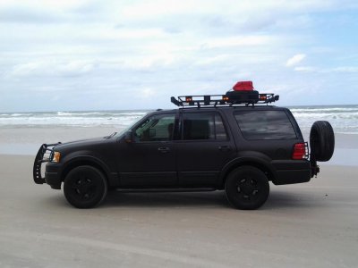

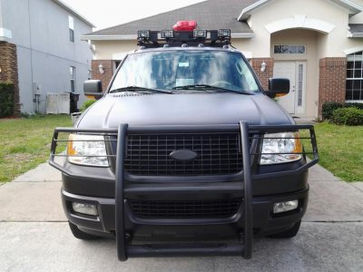

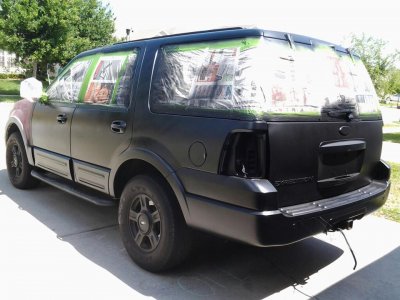

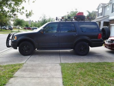

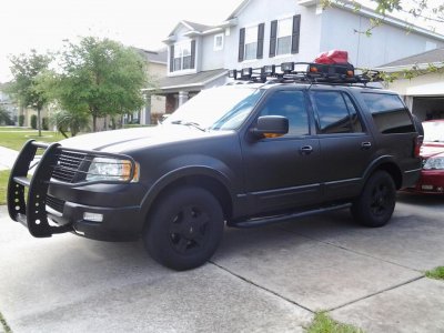

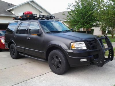

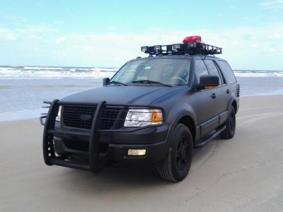

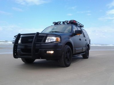

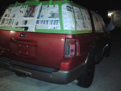

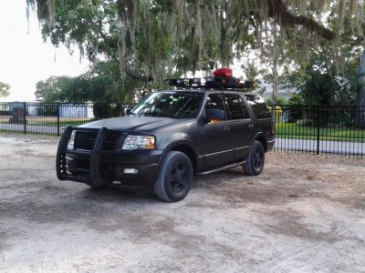

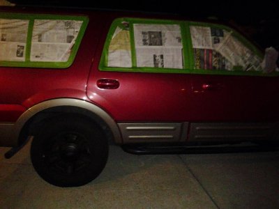

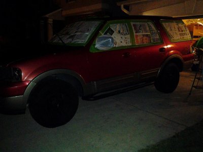

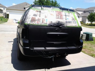

FINALLY HAD TIME TO PAINT MY TRUCK...I DID IT IN MY DRIVE WAY...I STRIPPED IT, TAPED IT, USED 96cents FLAT PAINT FROM WALLMART (20 CANS)...USED A $36 SANDER FROM WALLMART...I USED 120 GRIT SAND PAPER ON THE ORIGINAL PAINT...THEN PRIMED IT...IT WAS REALLY WINDY WHEN I DID IT SO IT LOOKED HAZY SO I SANDED THE PRIMER WITH 180 GRIT SAND PAPER TO EVEN IT OUT....THEN I USED A WAGNER SPRAY GUN (THE HVLP ONE) IT WAS ABOUT $69 AT HOME DEPOT...I USED HIGH HEAT RESTOLEOUM BBQ PAINT SATIN BLACK, ABOUT $16 FOR EACH QUART I BOUGHT 5 OF THEM...DID ONE LIGHT COAT AT FIRST...WAITED ABOUT AN HOUR...THEN ONE SECOND HEAVY COAT...WAITED ABOUT 30 MINS...THEN A THIRD LIGHT COAT FROM A DISTANCE...ABOUT 15" TO GIVE IT A TEXTURED LOOK...AND TO ME IT CAME OUT PERFECT IT PAINTED VERY EVENLY AS LONG AS YOU KNOW HOW TO HANDLE PAINT....GIVE ME YA'S OPINIONS GUYS !!!!

Like I said in your comment box. Looks good. I must have seen the pic just as you had put it up. We need to meet up one day so i can check it out in person.

Looks great. My only feedback is that you need some more aggressive tires. Some duratracs or something similar. Just more umph...But otherwise, I really like the look you are going for.

Thanks guys....@ Sgtowing...no problem my wives best friend lives in Seffner so i head that way alot...i'll let you know....@ Lane24..im working on that now i just wanna lift it first so i can have better clearence...

i don't know if you even need to lift it. It lookes pretty sweet as is. Like I said. Just throw some aggressive, wider stance tires on it. But if you are thinking about lifting it, that's even better. But good job either way man.
