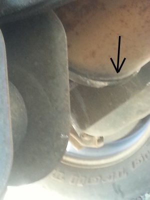

Not sure if that's connected but this morning I pulled over to see what the noise is or if something's loose or fallen because it was substantially louder and when I looked underneath from the passenger side rear area, I saw a spray of liquid pouring out from this part of the vehicle, big foot wide splatter on the ground and the fluid was dark and kind of brownish. I thought it was gasoline, kind of that color and it may have been but it didn't quite smell like gasoline. I dabbed some on my finger and a larger blotch on a napkin and it didn't smell like gasoline but had a faint gas odor beneath more of a metallic smell.

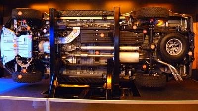

I'm adding two pics. One is a pic I just took from the phone of the specific area the fluid was spraying out of earlier. The other is some other vehicle pic I swiped off the web to point out the area of the part in question.

1) Video with sound would help determine the source of the noise. Does the sound stop when the brakes are applied? Do you have all of the hub caps still on the wheels?
2) First pic looks like the bottom of a muffler. If it is, the liquid is condensation in the exhaust system.

The pic is the area still wet from this morning when it sprayed out whatever it was. but only a half dollar sized puddle after I'd driven 12 miles and parked to go in the bank. I checked when I came out and since then nothing more but I'd assumed that it's because whatever was in there drained empty.
