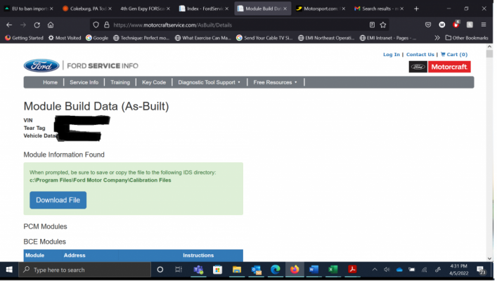

Input your vin into the website below and it will provide you with your factory as built data.

On the first page you should be prompted to enter VIN. On the second it should give you the option to download the as built file for the vehicle. Attached screen captures for guidance on how it should look.
