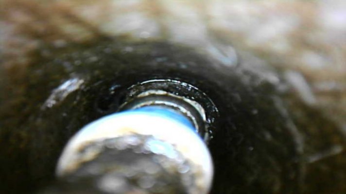

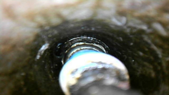

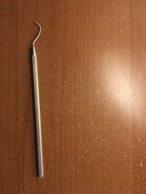

Is the spark plug in or out? I like the hunk of wire made into a u shape. So the thin grabber tool wouldn't get in there? You can get different sized adapters to shrink down your shop vac hose. Empty the inside before you start. That way you won't have to root around the dirt and gunk to find out if you sucked it up.
spark plug is in. i cannot see it its blavk. only way i found out was with an endoscope. thx alot guys!!

3/8 ended up being the same size as the oring. going to try 5/8 id. my friend is comming over with a pair of long needle nose, claims he can pull it out.
