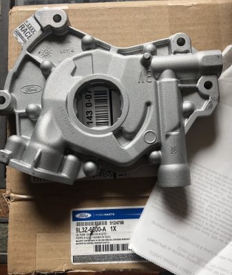

I just got through my second rebuild at 260K. Summit has the Melling High Volume oil pump for around $140. The 5.4 has a tendency to starve the PX side bank. I would replace the oil pump. Oil pressure and volume with be the thing that keeps the engine in good shape. You are this far into it and spending $140 on a good oil pump will pay dividends in the long run. You don't see the wear that is inside the pump, but at 150K you are down on pressure from the factory build. Low oil pressure will take out your cams. When you have the valve cover's off, check the cam lobes. If they small black lines around the lobe, your pressure is down.
6,510
3,123
Thanks for all the advice I appreciate it and value it. Rattled this morning so this stuff is not in my imagination....it’s going to make me cringe driving through the winter knowing this. Ah well at least everything in the short block isn’t effected by this timing set crap.
So I’m going to go with the Ford kit on amazon, and then order the oil pump as well. Hopefully the passenger camshaft and followers etc hold out for me fingers crossed.

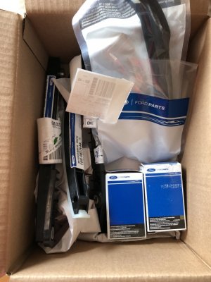

Don’t get the freedom racing kit since the phasers have a tendency to malfunction and not hold timing. Get the kit on Amazon that FordTecMakULoco recommends. I have it, the Melling pump, and all the tools in my Amazon wish list for next spring.
Does anyone have a link to the Melling timing kit that was mentioned earlier in this thread?
6,510
3,123
The freedom racing kit posted is all Ford oem. The Ford amazon deal provided by babycakes311 is $50 cheaper than freedom racing anyway however so that’s the winner.
