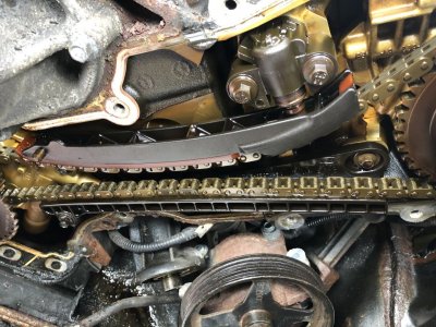

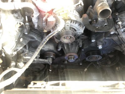

Here is a picture of a tensioner beginning to blow out. If you have occasional rattles it’s going to look like this.
I must be lucky. Four hundred thousands miles on (3) 5.4L Expies, never had to replace any of those parts. Of course, I only replace parts that need to be replaced. Always ran 5W20 & 6K miles oil changes too.
I often thought of using red Permatex # 1 with those tensioners (It dries hard). That stock pump you have will work just fine.Christmas in March, I have most of the OEM timing parts as of today. Bonus is everything is made in USA:
