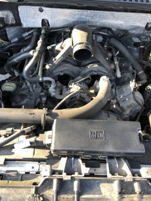

I just started my 2014 after a week of it sitting in the driveway, as I was driving my other "work car" all week. I raised the hood to listen to any rattle.
Oh man! That f**ker sounded like the chain was gonna come off, lol! A hard metallic rattle for about 2 seconds, then all quieted down. I've never noticed this before when I was driving it more often this summer. The 7 days of sitting in the driveway plus the colder temperatures really drained those tensioners!
Well damn... looks like I'll probably be in the market for a timing kit and a high volume oil pump too. 132,000 maintained miles on mine. Thank you, Ford D-grade engineers!
(the myth that a timing chain setup is "for life" doesn't hold true with Fords! They might've just as well put a g-damn timing belt in those 5.4's...)

You might be ok, 7 days and many cars would do that methinks. It’s not just the 5.4 3V, the older 2V Windsor engines have the same plastic tensioners that blow out. The difference is our 3 valves have Variable Cam Timing hardware and knock/throw codes after a while of the issue occuring. The older 2 valves just wasted the head without much warning from what I understand. The Modular engines, Ecos, Cyclones, etc all use these plastic oil pressure driven tensioners. They work for the most part but are a known issue.
