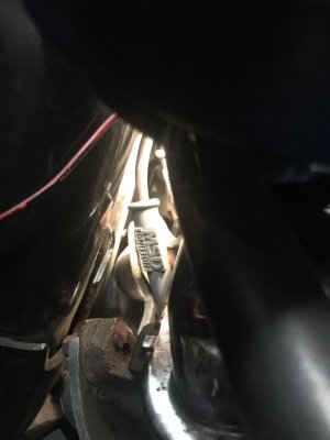

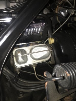

5C8B30A6-F3E6-45EF-8DB0-96AEDCD2AAED.jpeg C12E18C1-698B-4864-8E77-1FECED1EA079.jpeg B3DDB1EC-DC91-4A51-AC54-7FCA02745F1B.jpeg
Suns out but this job is still a living Hell for me. I don’t know I’ve ever been so upset and aggregated at something in my life. The drivers side valve cover is being an absolute nightmare. These engineers need a swift and hard kick in the ass or a beating for this design. It’s almost intentionally done so it can’t get serviced. My torque converter replacement was heaven compared to this. The good news is everything inside looks in great shape, shame on Ford bean counters and engineering for using cheap tensioner gaskets causing non needed repairs and continuing using them despite KNOWING the problem. I’m sure they’ve caused a lot of heart attacks with this anger inducing crap.
Hey Ford engineers have been making it hard on mechanics for decades. My factory Big Block 69 Cat is absolutely shoe horned in between the shock towers. All my old Chevy buddies have had it way too easy working on their Chevelles ,Camaros, and even Deuces with tons of room
in the pump house. My 69 Stang I had before was also hard to wrench on even with a small block Cleveland tucked away. It’s an all day love affair putting header gaskets on the Cat. Up top and underneath back and forth to tighten/loosen some of the bolts with a 3/8” box and open end wrench with motor mounts unhooked and motor jacked up. Even the power brake booster barely fits. When people say the old cars were easy to work on they aren’t referring to 60s FoMoCo shock tower cars. There is literally a gap as wide as notebook paper to slip between headers and towers. My Chevy buddies are ******* taking the easy route! Lol!

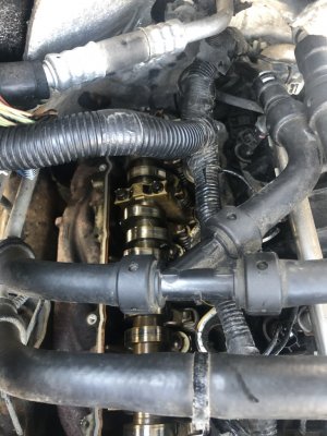

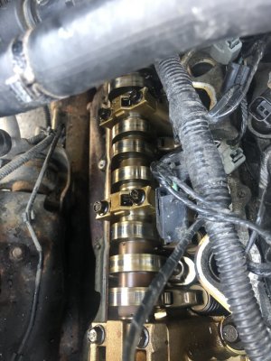

Decided pulling the cams is the best approach. I’m glad I can do so, me never having been this far in didn’t know if pulling cams would create issues with followers dropping retainers but it apparently doesn’t. Thank the lord lol. It’s easy to do research outside but once the Ford Gods are staring you right in the face for the first time it’s definitely a different experience!!

I’m throwing in the towel for the day...yet again the common knowledge on the web is incorrect. The passenger side valve cover is MUCH easier to remove. Simply take out the battery box. I’ve fought with the drivers side for 2+ hours to no success so I’m calling it a day. Drivers side is much more difficult. I found this interesting since EVERYONE claims the opposite. Totally false. You can easily access every fasteners on the pass side through the wheel well, no such luck in drivers with steering shaft and extra ABS equipment.

View attachment 35551 View attachment 35552 View attachment 35553 Hey Ford engineers have been making it hard on mechanics for decades. My factory Big Block 69 Cat is absolutely shoe horned in between the shock towers. All my old Chevy buddies have had it way too easy working on their Chevelles ,Camaros, and even Deuces with tons of room
