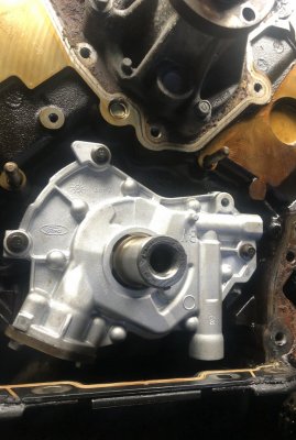

I am still replacing both tensioners, all guides and arms, and the oil pump. If you are in here replace whatever you can afford to do imo. The guides may be in tact however the chain has been slapping them for some time on startup, so do yourself a favor and replace them. I’d bet they are brittle now.

If you are on the slimmer side like me do yourself a favor and work on the oil pump from below. It was a priece of cake to get at even the more difficult bolt from below.

You have a point about the guides being brittle and mine was a 2 valve and had good pressure so I left the pump in there. What size wrench do you think the nut on the fan clutch would take if I had one? I will be replacing the current 5.4 pump with a Ford one eventually.

You folks might want to pull the oil pan to get bottom oil pump bolt. It’s hard. I had to magnet it out already. Just the last bolt a nightmare. Having a hard time keeping my golden retrievers fur out of motor lol.
