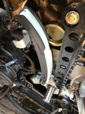

For now watched some YT tricks at getting the timing cover off without pulling valve covers off and just loosening them up. I’m installing new tensioners, guides, arms, and a new oil pump for good measure so it’s not getting the whole 9 yards. I’ve watched a bunch of videos where guys just went after the oil pump alone and it seems straight forward. The guides and arms as well as tensioners are super easy.....you install the tensioners to torque specs and pull the grenade pin and ready to go it seems. I have the special little ratcheting wrench for the oil pump too.
