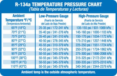

I have charged it with freon and it says it's full, the compressor is working, the air is not cold, door actuators are working, any idea what else it could be?
