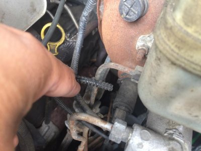

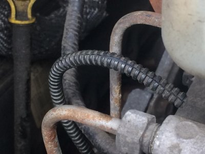

Well my Abs light came on. Have no idea which sensor it is. But as I was under the good look at the brake fluid. I notice this plastic tube just floating there. Looks like a Vacuum line but have no idea where it belongs too. Does anyone have a clue?
