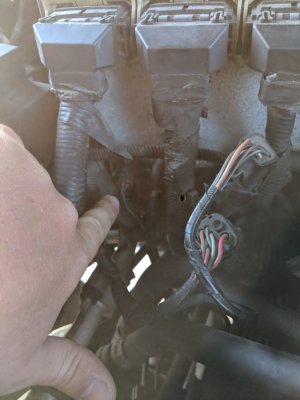

Sorry for the double post. But I wanted to double check. This is the low pressure switch right? I'm pointing at what I think it is. I found a diagram online and tried to follow it. IMG_20180503_070117.jpg
